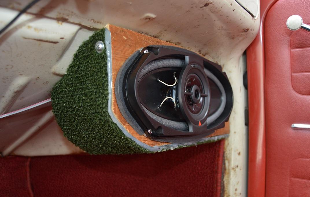

Built some boxes for the speakers hoping to improve the sound quality a bit, especially the bass. I don't know much at all when it comes to speakers but hanging them out in the open was not the best for good sound. I used more of the dryer pipe metal to build the boxes and then covered them with leftover carpet from when we did the interior on the '65 Riviera. It's green but oh well. Christmas spirit or something. The bass is much improved, and the overall sound quality is a lot better, so the boxes appear to be doing their job. The driver's side was a little trickier to make accounting for the hood release knob, which is still accessible. Adding the boxes was definitely worth it. Still thinking on the speaker covers.
Passenger side box.
Driver's side with indent still has room to pull the hood release.
Added some rubber between the speaker and the mount thinking that sealing it may help the sound a bit too. Plus, it was really easy to do.
