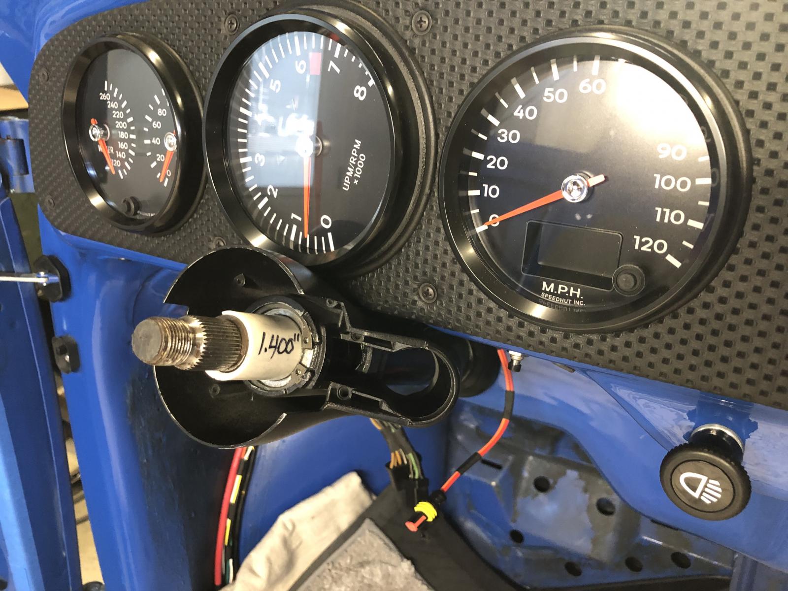

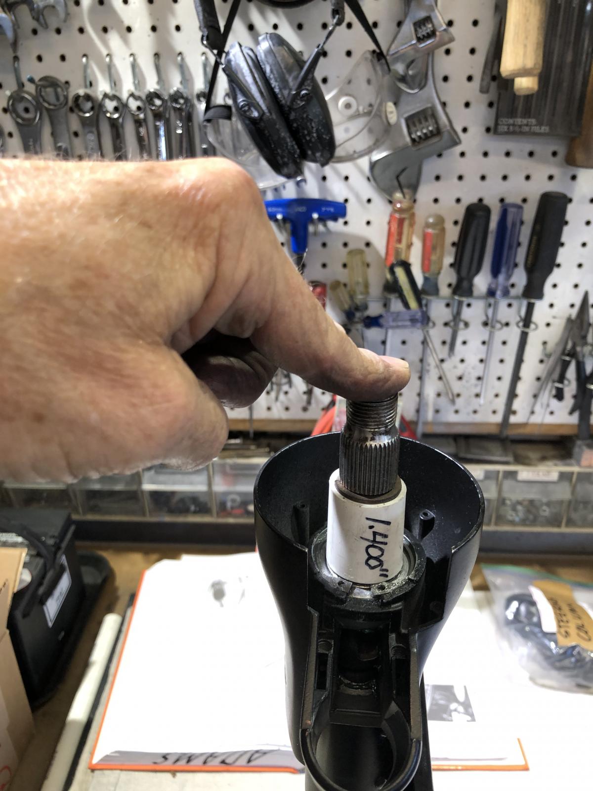

Welp…that was disappointing…
I’m rebuilding the steering column for install so I can complete the wiring of the turn signals/wipers. Per other vintage SB owners, the lower needle bearing disintegrated upon removal…
…the outside plastic sleeve of the “sealing ring” (#7 in Fig 9-12)…
…crumbled away, no longer providing an interference fit in the column tube. It retains the #8 needle bearing in the tube. Without that, the shaft is “free to move about the cabin”!
So I ordered the seemingly ubiquitous fix…the “high-tech” Nylatron lower shaft bushing…
It’s available from a variety of vendors. I’m not disclosing which vendor I bought it from as, from what I can tell, they all seem to be from the same source and I don’t want to soil their otherwise sterling rep.

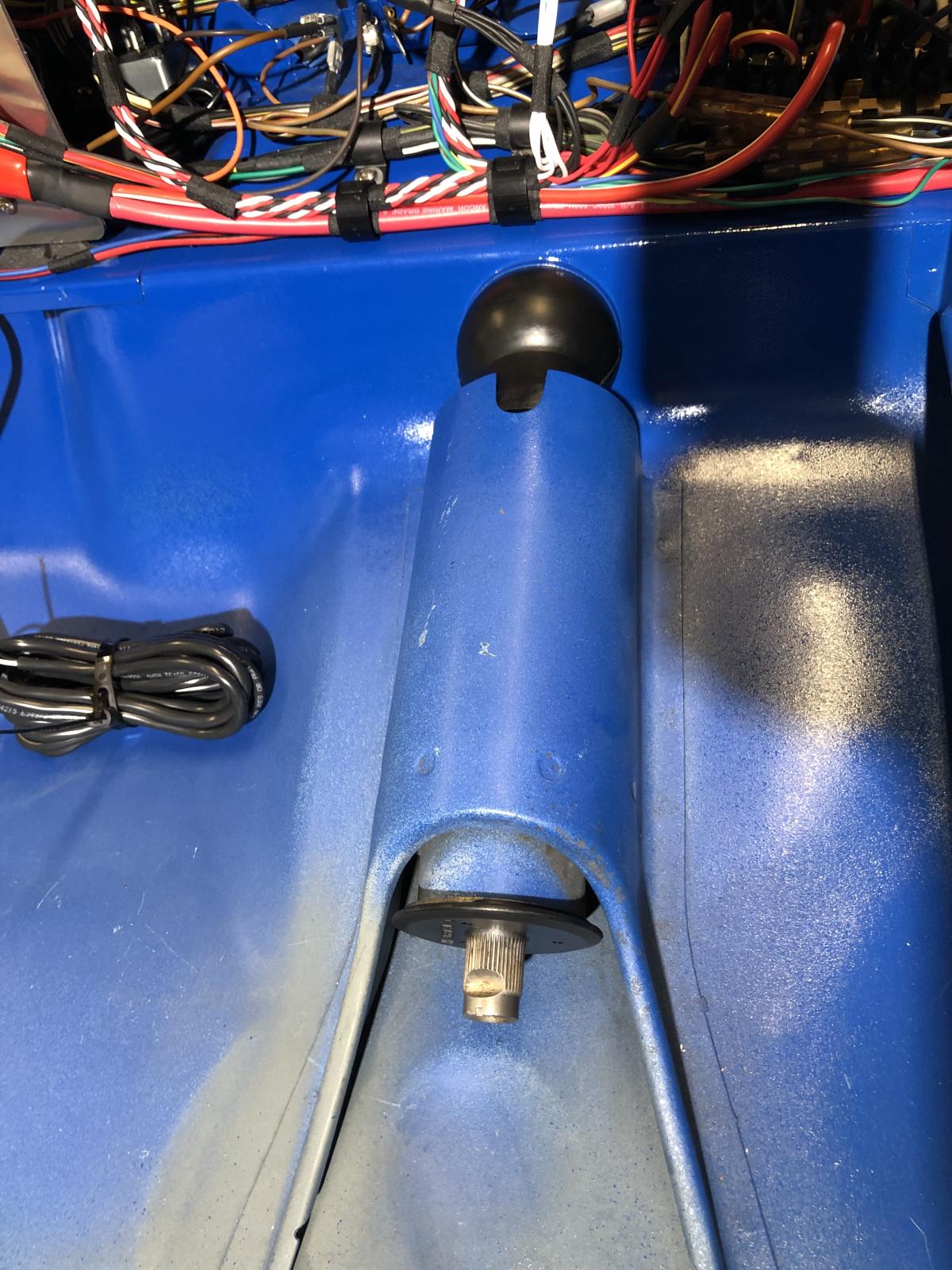

Steering column rebuild parts came in today…
Porsche needle bearing replaces the self destructed OEM unit…fits exactly like OEM…
A ‘72 OEM SB steering shaft off eBay (top) replaces the one I ‘ruined’ trying to install a plastic bushing instead of a proper bearing (see last post)…
Porsche 911/914 steering shaft stainless “contact ring” (aka anti-rattle bushing) fitted (flange side against shaft stop)…

For the upper spacer, I measured 1.400” for the length. The upper spacer along with the upper most circlip, prevents fwd shaft movement (aft shaft play is taken out by the shaft stop butting up against the upper bearing which is retained by the housing).
I used schedule 40 PVC pipe and added an additional 0.010” to the length to take out all fwd play…
…the pipe’s ID is smaller that the shaft so I split it…
…installed…
Added the “support washer” (plastic side against universal joint boot)…
Installed the start switch…
…and plugged in the wiper/turn signal harnesses…
The steering shaft rotates so smooth with no stiction…night and day difference from what I had going on with that plastic lower bushing…absolute zero fwd/aft play in the shaft. Very Happy Thumbs Up Thumbs Up
Ready for a steering wheel!

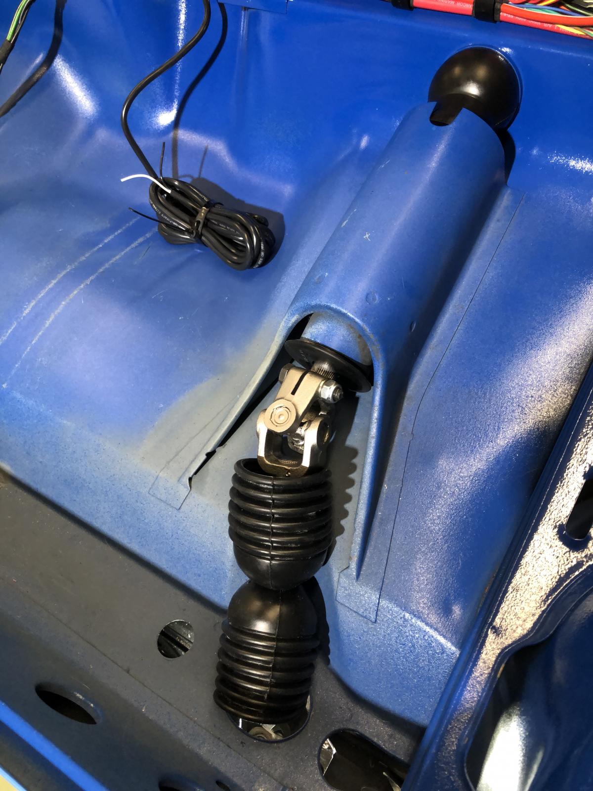

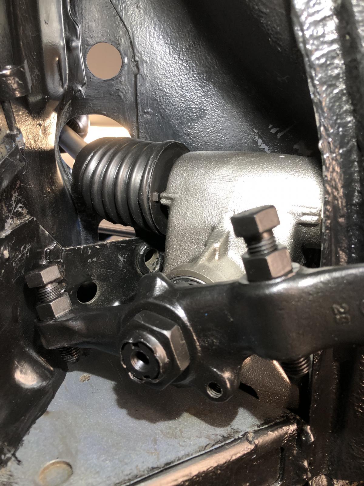

Connected the steering shaft to the box…
OG steering universal shaft is tight w/no play…so reused. I cleaned, painted it and put a few drops of Tool Box Buddy oil in universal joints. New boots…
J.
