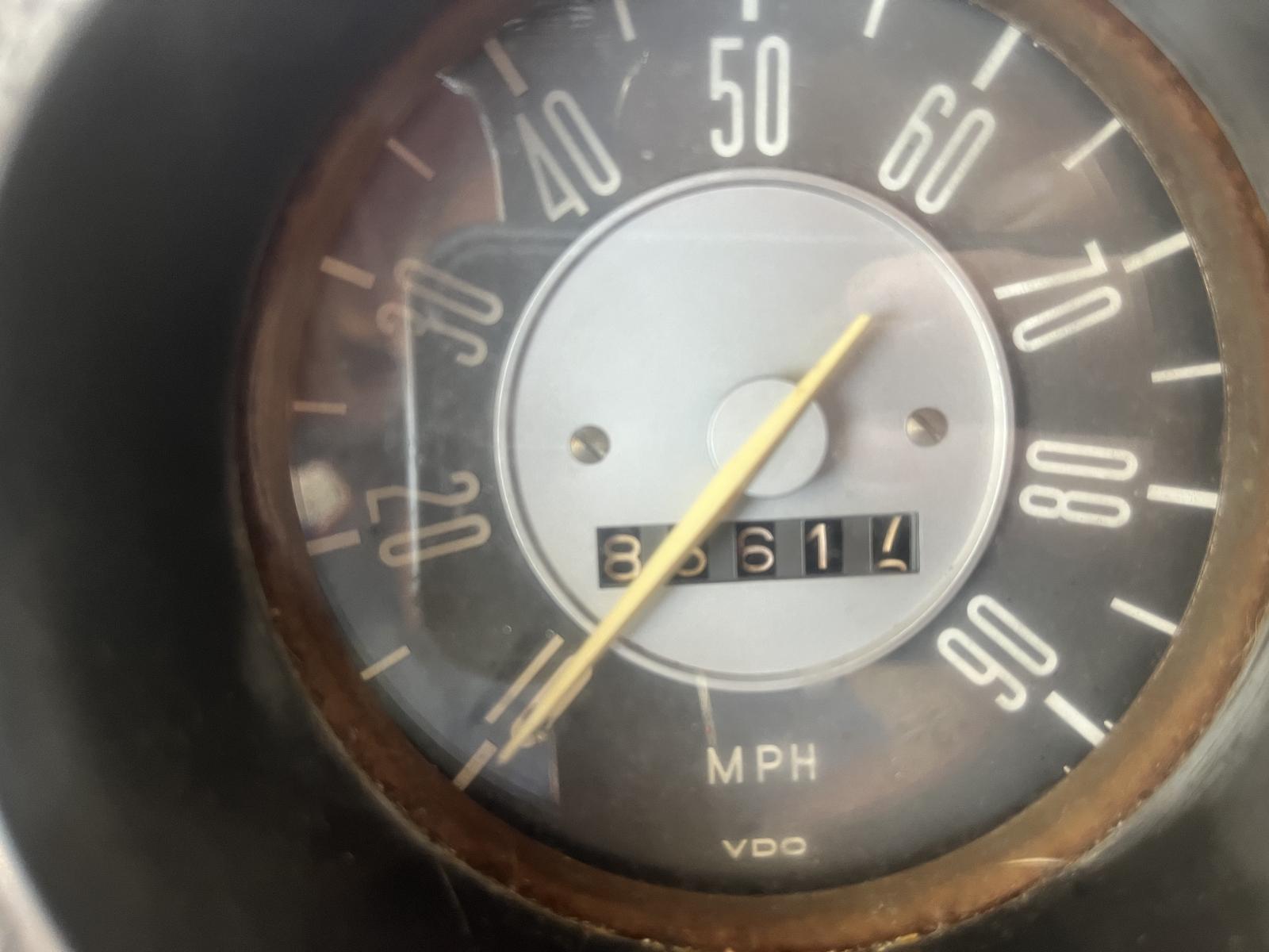

Since getting the speedometer functioning last August, it seems that I’ve only racked up roughly another 7,000 miles…
I’ve been driving the diesel caddy the rest of the time. Embarassed

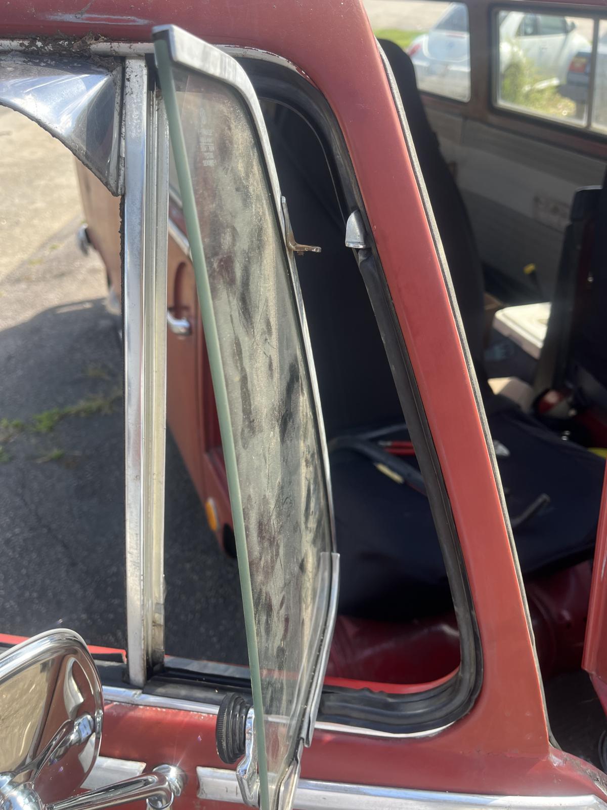

Speaking of which, yesterday I decided to toss a new vent window seal in. Nothing exciting, just the vertical piece that seals the vent wing to the window track.
And using a dull screw driver to coax the new seal into the track. Here it is back in place.

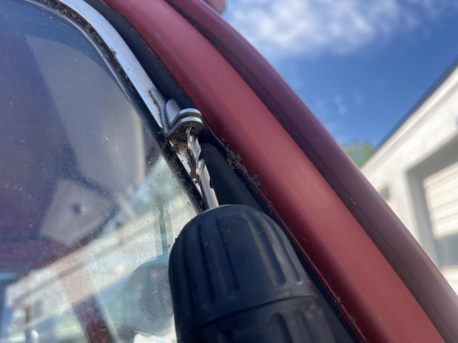

However, this morning I opted to install the other seal. Being a slack ass & trying to avoid tearing the whole door apart to remove the vent wing assembly, I drilled out the original upper rivet.
And gently pried the old rivet out.

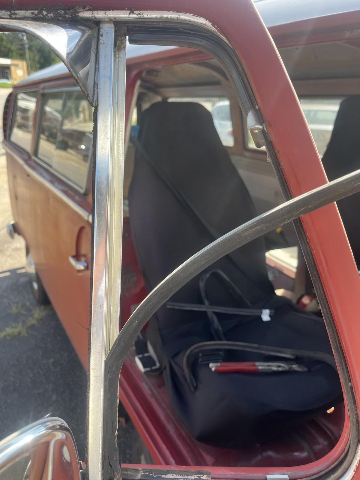

After rotating the vent window 90°, I lifted it out.

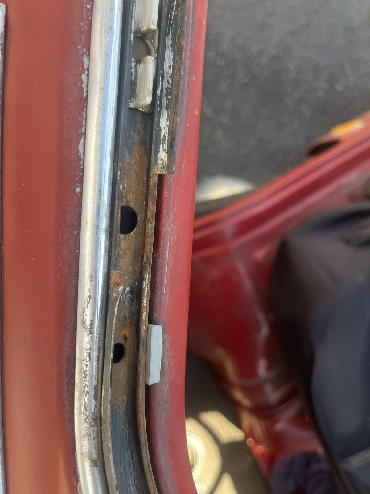

Once that was removed, I stripped the old seal out, cleaned up the vent window frame & shot some paint over the exposed metal. Being the halfass that I tend to be, I didn’t even wait for the paint to cure before stuffing the new seal into place.

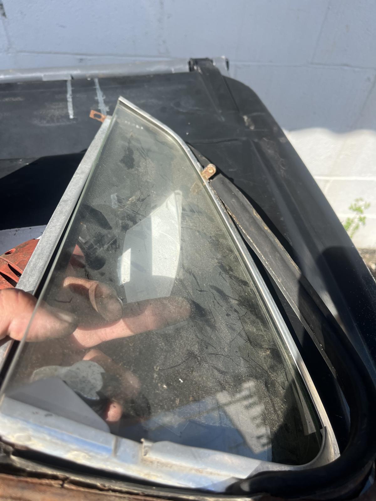

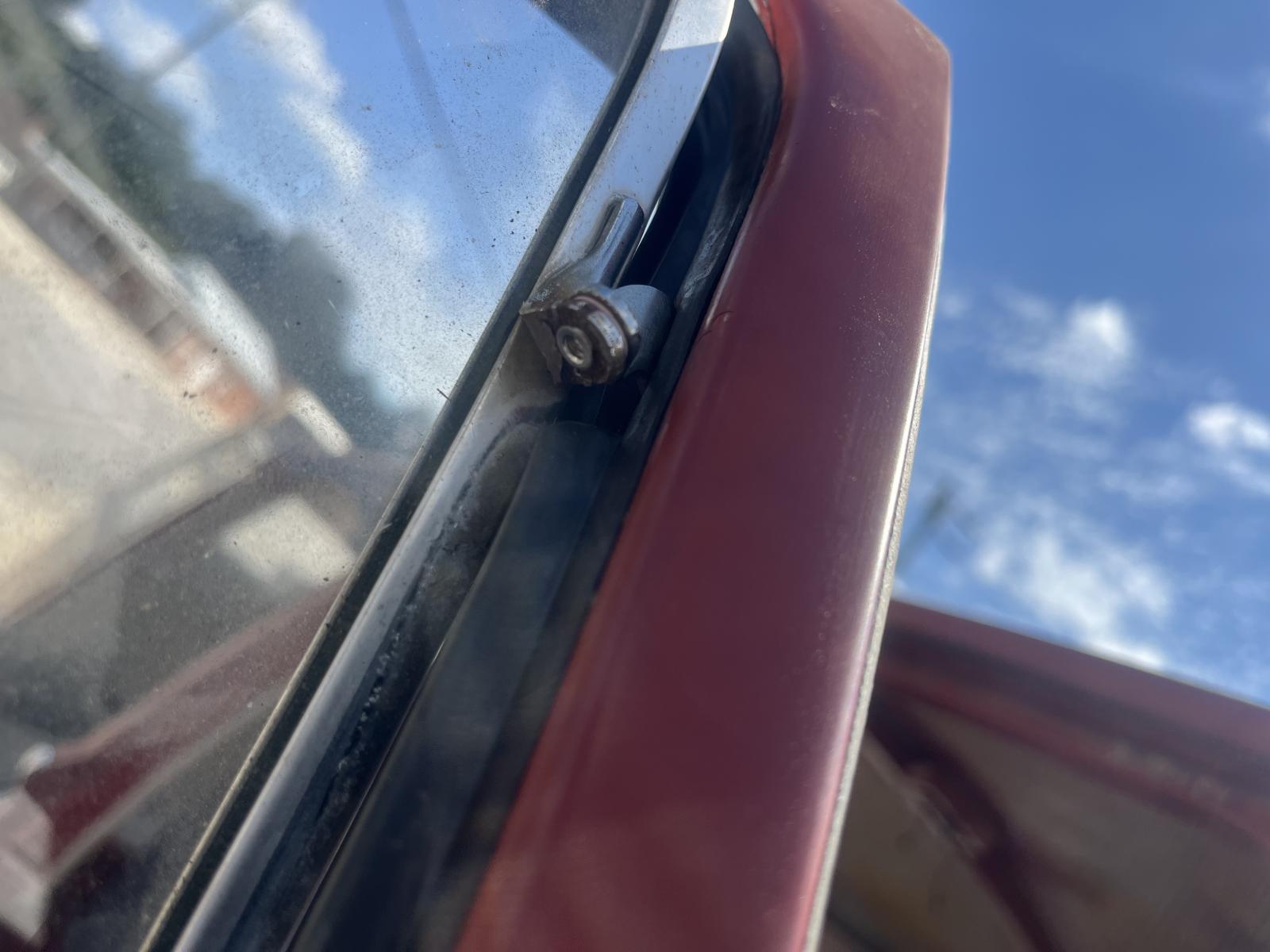

Since the rivets on the lower pivot of the original vent wing were worn & loose, this caused the wing to vibrate or flutter when driving. Having another old window with a rotten frame laying around, I separated it from the frame & set this one back into the bus.

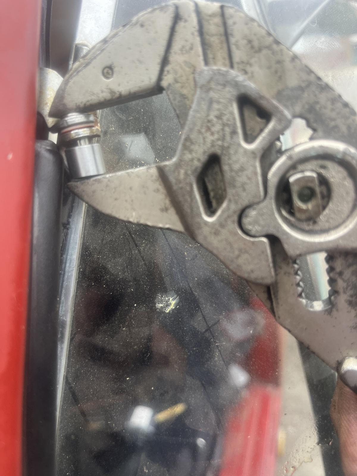

Wondering how I was going to set a new rivet while the assembly was still in the door, I searched for a rivet setting tool. This led me to one for a Ferd truck rivet tool available through Jegs automotive parts.
Alright, with a plan in mind, let’s fuck it up.
First off, not having a lathe, I chucked it up into the drill press.
And proceeded to cut it off with a die grinder.

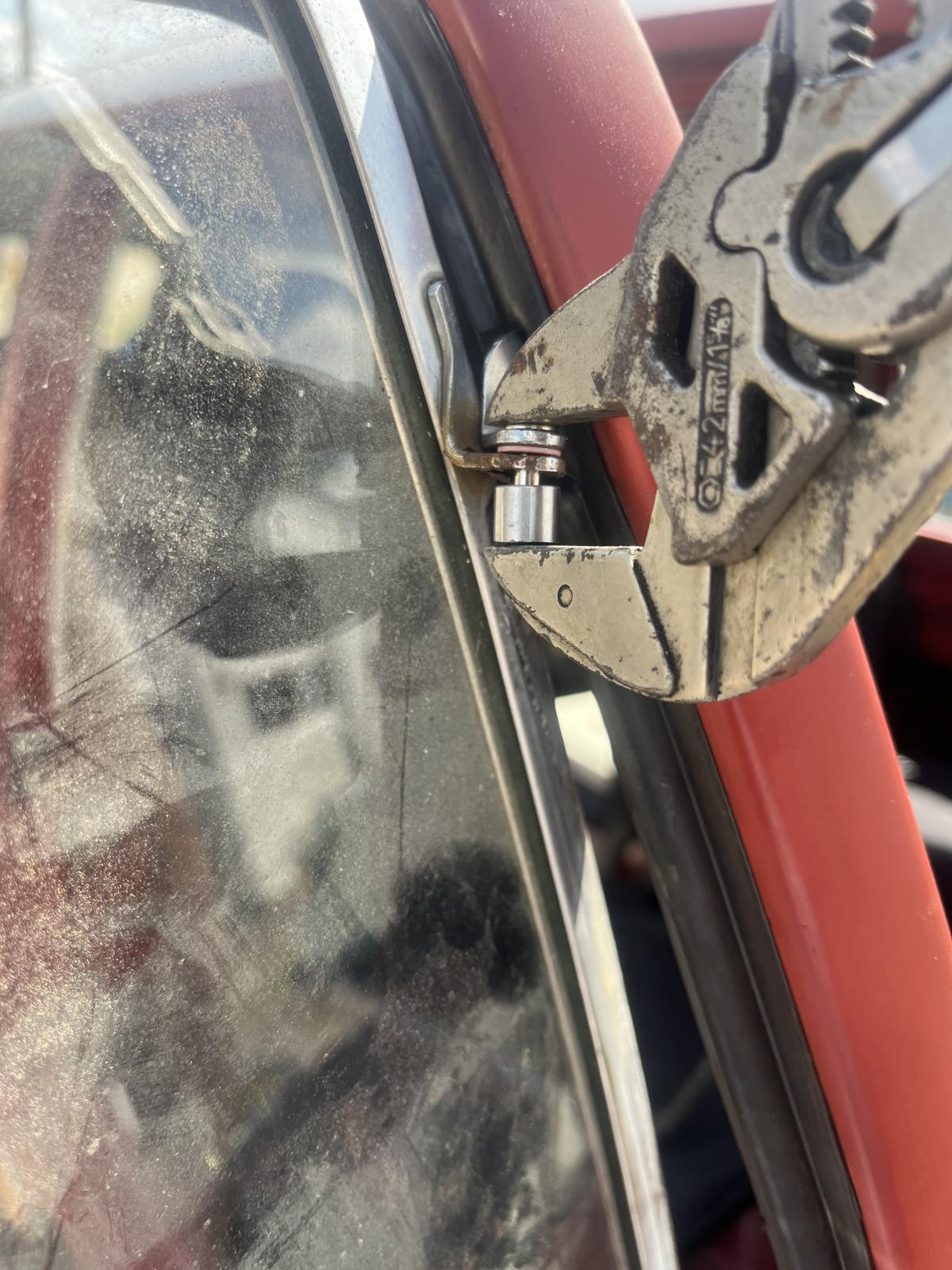

Which left me with a cute little mandrel. After fitting the rivet & washer in place, I fit the mandrel in place & clamped it with this wonderful pair of Knipex parallel jaw pliers.
And gave it a big squeeze.

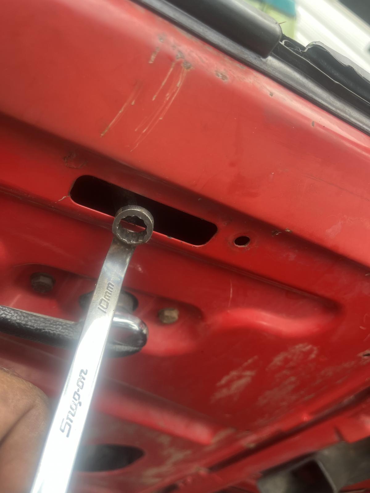

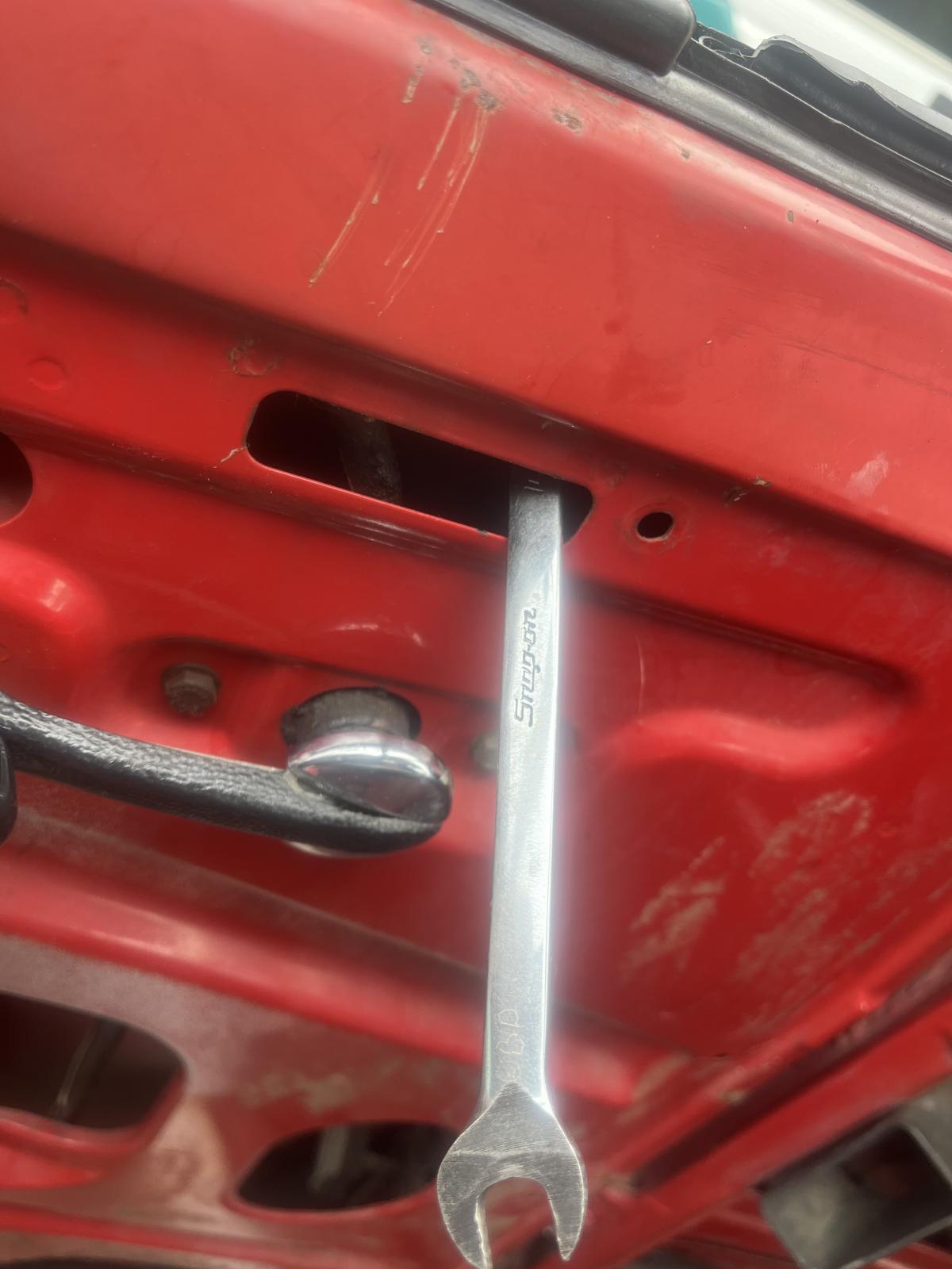

Once compressed, I then used a 10mm wrench that I had modified years ago to install a turbo actuator on a TDI, it’s almost as if I made it specifically to adjust the tension on the vent wing pivot. Shocked

Today was just performing everything I did yesterday on the passenger side.
Except for straightening the window frame.
I used this donor because it still has the latch.
I removed the window again because I thought it’d be easier to install the seal on the divider while the glass was out.

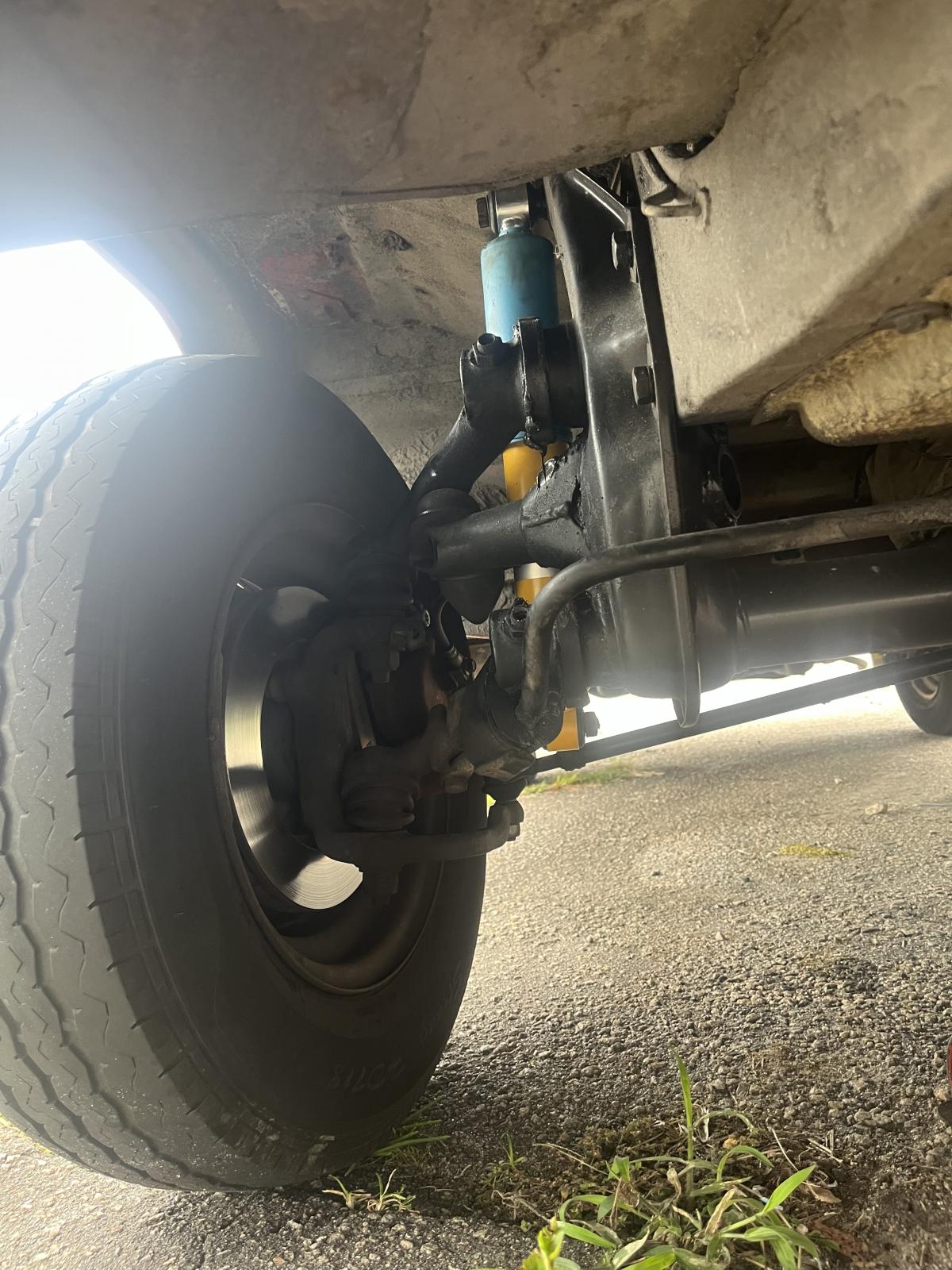

With the rear of the old beast doing its best impression of a pogo stick, both audibly & handling wise, I ordered a set of Bilstein shocks.
While Rock Auto had the fronts in stock, they didn’t have them for the rear. However, with a bit of research, I found that rear shocks for a Vanagon Syncro were just a hair longer. Being that the Vanagon was probably pretty close in most other aspects, I scored a pair.

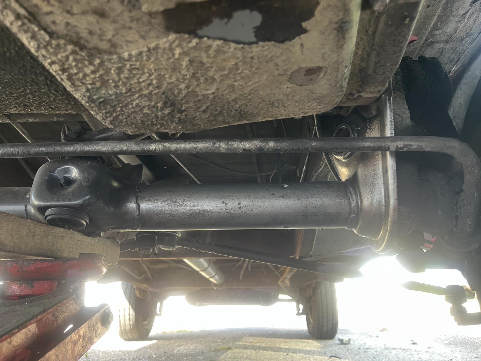

Here’s the source of my pogo stick sound…
You can see where the helper springs were rubbing on the shock bodies.
And, as suspected, the Vanagon Syncro shocks are pretty close.
Hopefully the beast wasn’t dependent on those helper springs.

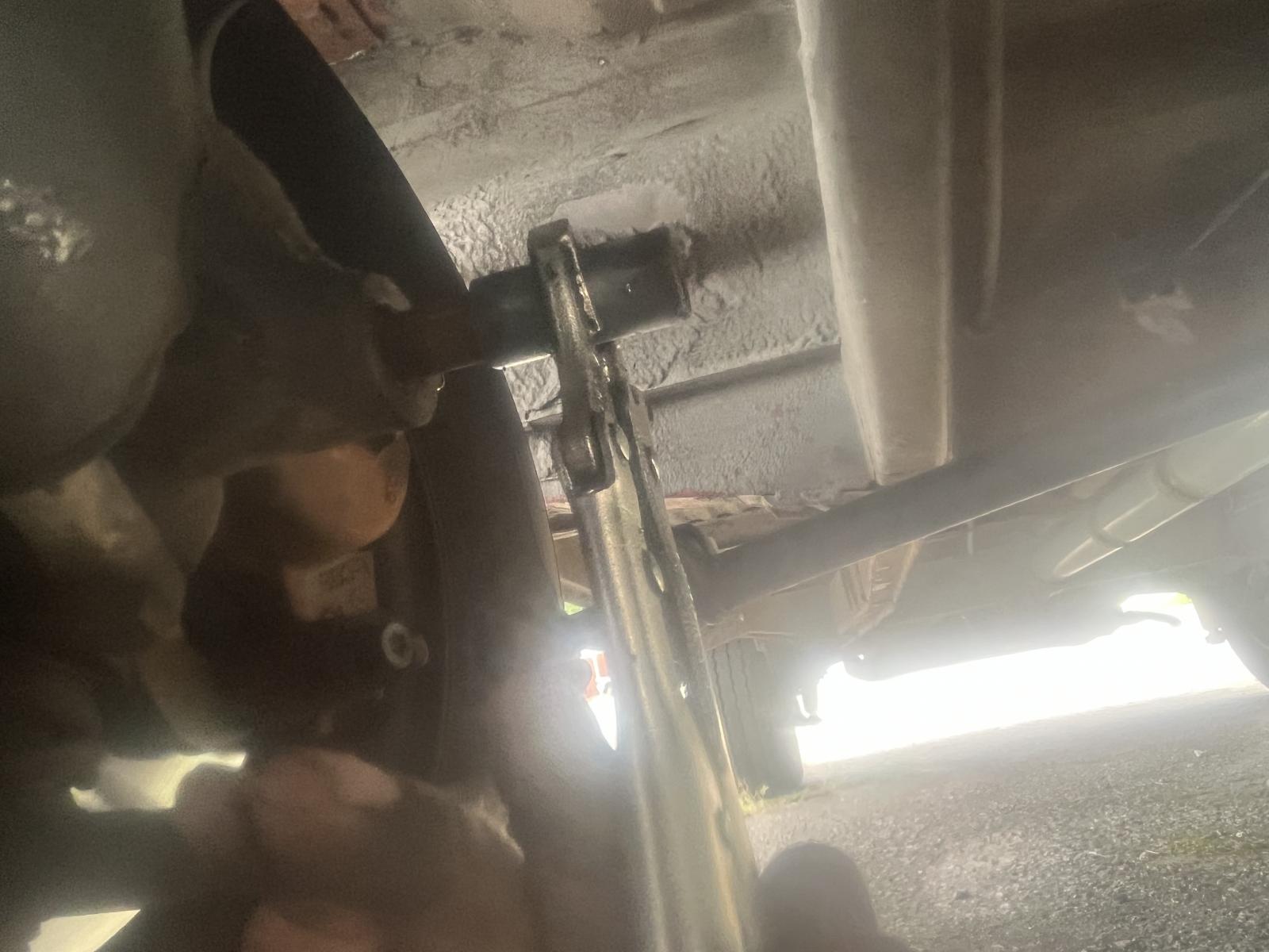

Moving on to the front, you can see how whipped the bushings were.

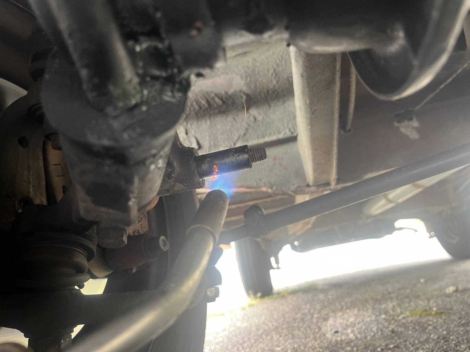

In fact, the lower collar stayed on the trailing arm.
So I introduced some heat to it.
Grabbed it with some vice grips, & twisted it off.
Yeah, those bushings were crunchy.
Here we are after installing the new shock.
