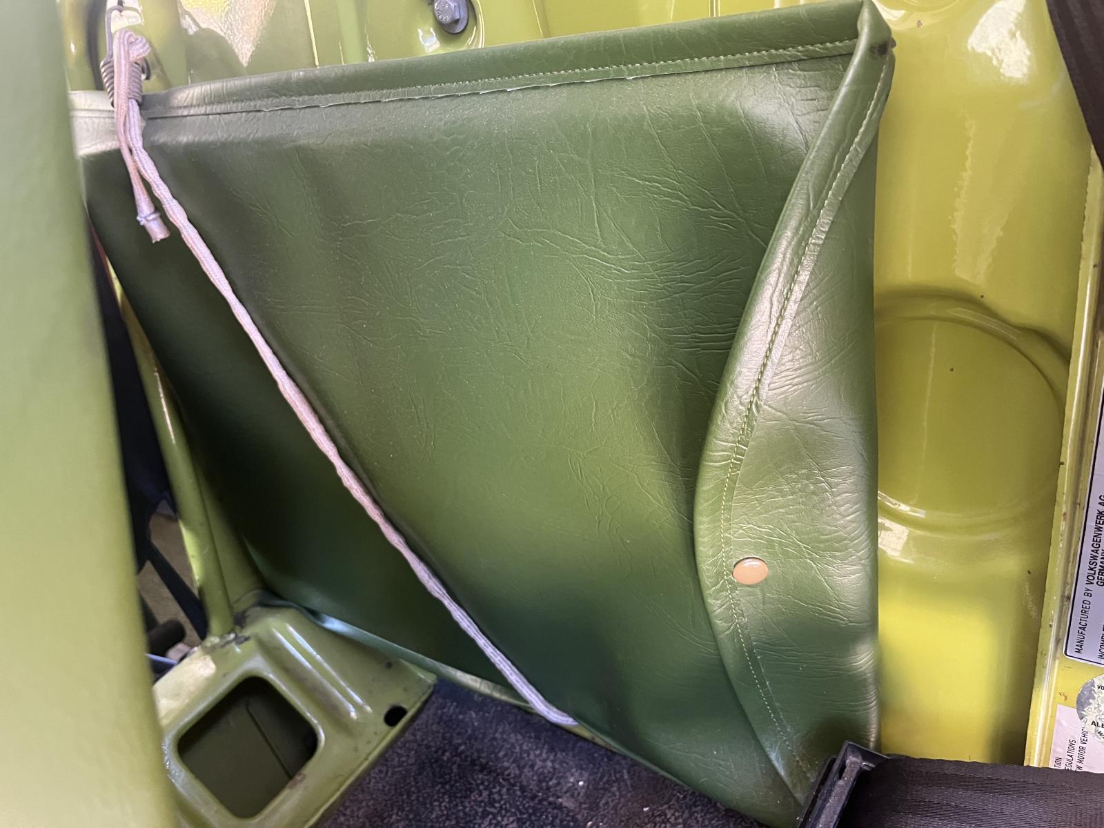

Is coolbugfan still in need of information? I might even have all the table goodies to sell (except the carry bag). But I have all that stuff in my current bus too. I’m on the road with the bus and could provide more DIY info but you need to follow up with your post. I get work/life stuff can stall things but people here are taking time to respond.
Keep on Busin'
carry bag for front table?
what’s it look like, x?
any other table goodies other than table, clips, and leg stuff?
There you go Tom. Not any other goodies. Just what you mentioned.
Keep on Busin'

PostPosted: Thu Aug 07, 2025 1:39 pm    Post subject: Re: Small Dash table Reply with quote
thanks, x. never seen one. wonder if they came in brown?
I’ve never seen one either until I got this bus a few years ago from Ronin10. Maybe someone like NLA produced one at one time. Notchboy would know Cool
