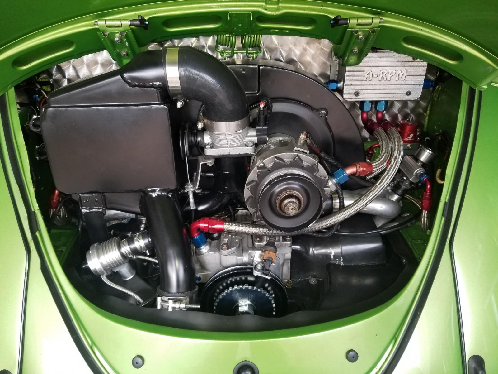

This pic is not my car but, I do own this Turbo Intercooled EFI setup. I bought it from the builder a few years back.
I just haven't been able to get around to fitting the system on my engine. Confused
