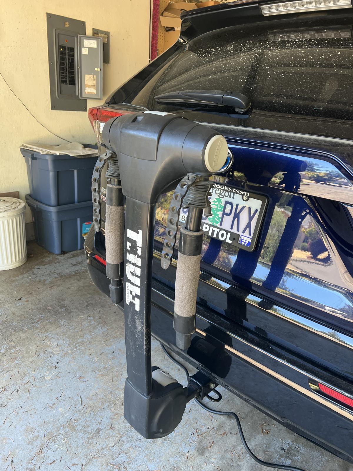

I have a Thule bike rack on my Toyota Rav4 and would like to connect it to my 1984 Vanagon. Has anyone had experience with using this hitch on their vanagon for their bike rack.
