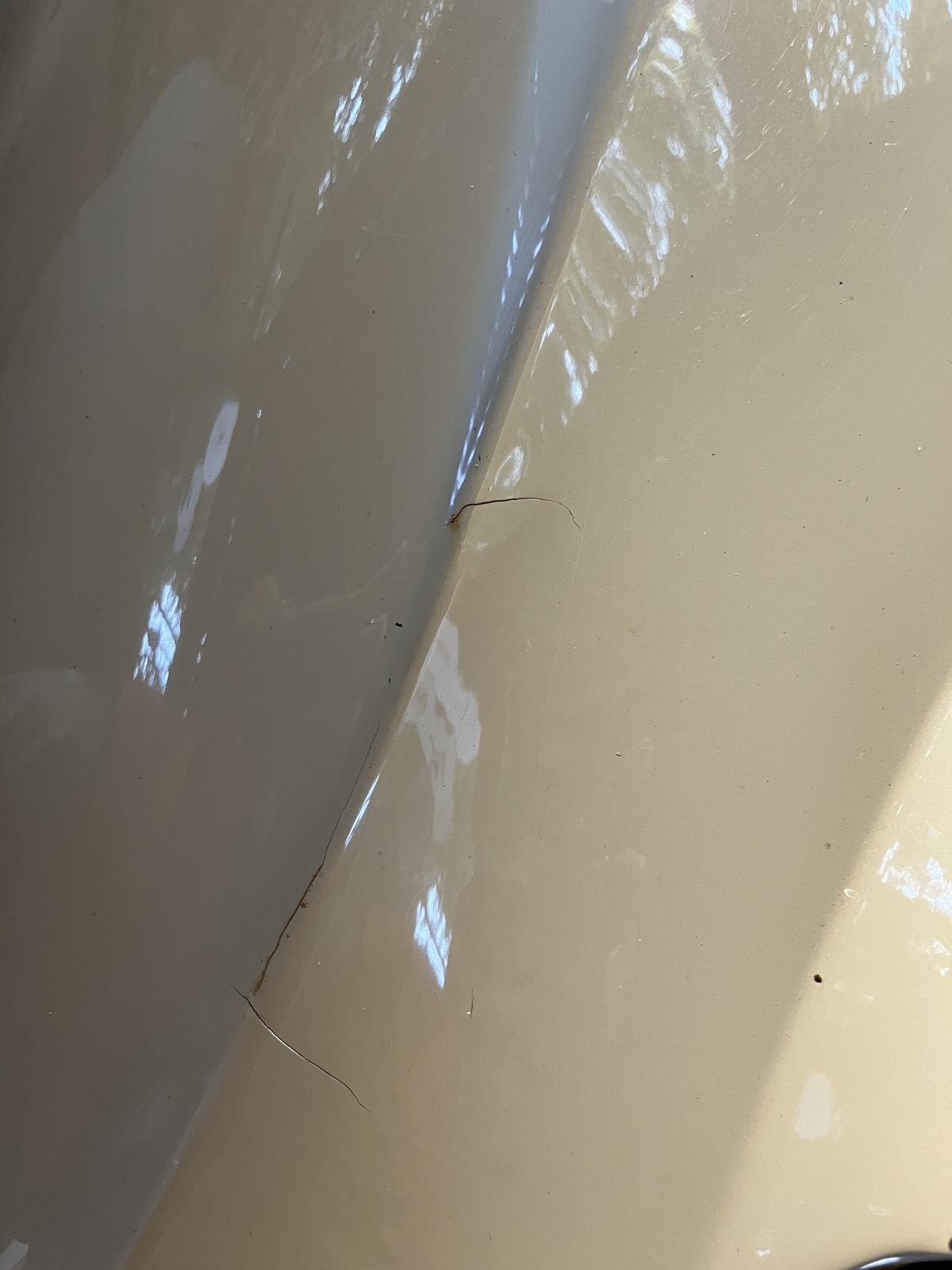

Glad to have a paint and body expert! I have a 1967 KG that was restored in late 2018. I bought it sight unseen from a very respected KG person in Oregon. It looks and runs great, but has developed a crack at the passenger side, rear fender (please see photos). I hope the photographs are enough to discern what might be happening...and to suggest a course of action. I'm in Atlanta, GA, by the way, and the KG is under a roof with a car cover. Thanks for any help!

That looks like body filler(bondo) failure. It can fail for lots of reasons including adhesion caused by incorrect metal prep, application of filler is too thick, metal fatigue caused by rust, and others. There is no way to really fix that without sanding it all off and starting over. Sorry for the bad news.

Got it. Thanks for the quick reply. Is there any "stop gap" fix I should do before I get it to a body shop?

You could try cleaning the cracks real well using a small brush and a paint prep product, drying it with a heat gun and filling the cracks with a liquid epoxy. Maybe use a syringe to apply for neatness. This would at least slow down water intrusion, but will not solve the problem.

Two ideas.
You could try a magnet in that area to see where the magnet will fall off, or not. That may give you an idea of how big the filler/bondo area is.
Also, pull at least that wheel and check on the back side to see how damaged/bent the body metal is.
While you're at it, check the whole car. Someone with a lift may be able to save some time on this.
