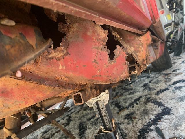

That is a lot of rust where the longitudinal "were". I'd do a close rust examination before putting any money in it. Repaint could be hiding a lot of bondo rust repairs! Your issue with stuck doors could be caused by this. I hate the tin worm.

I DEARLY love 914s but you would be much better off spending money on a better car, this one has had heavy mistreatment, poor metal patching, and poor paintwork.

I hear what you all are saying. I have been lurking on 914World for the last couple months as well as taking a deep dive into the lengthy rustorations untaken there and on Youtube.
I am graduating college next month and don't have a money to throw at another tub and my goal here is to learn more than anything. I feel that any time that I put into this body learning to do rust repair is time well spent in my own skill set. Why not learn on a lost cause right? Like I said before, I have more time than money and a desire to learn on what I have sitting in front of me.
The external skin of the car seems to be in great shape, I have gone around it with a magnet and knocking and none of the panels seem bondo'ed up. The passenger front fender is blue on the bottom side while the rest of the car was originally yellow. It has a salvage title and I would guess that this is because of a front passenger impact. The PO claims to have daily driven the car 7 years ago and the tires don't show any unusual tread wear, but PO's claim don't mean much.
I think I am going to move ahead with the project, I have two loose lines on parts cars and I will see if the tubs are any better on those, but I am having trouble getting in contact with the owners. I also just had a 98 Subaru drop into my lap. My daily driver is a Subaru swapped 84 Vanagon and I would be interested in doing the same to the Porsche (I know it's blasphemy).

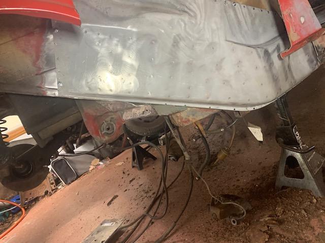

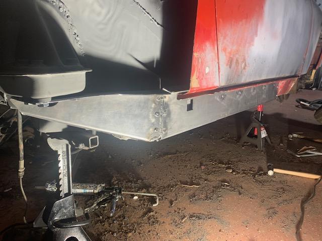

Hey, my project looked very similar when I picked mine up. The rust was bad when I inspected it but it was WAY worse when I cut the quarter panel back and started fixing it. Don't lose hope. They sell most of the sheet metal needed to repair this and some cutting, grinding and welding should have you fixed up. Take your time and measure before cutting out the rot, build jigs and fixtures to locate your suspension mounting locations and cut, grind, weld.
I had such a bad time with the fuel injection system (mine was D-jet) that I carb swapped it. Now I'm having an issue with cylinder #1 and #3 being dead even though they have compression and spark. Chasing down valve adjustments.
Moral of the story... don't give up. It's not too far gone. Similar to you I'm shooting for driver quality.
