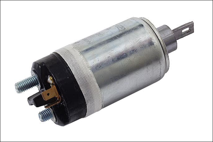

Hijacking this topic to see if someone can answer a related question for me.
I'm in the middle of a 12v conversion on my 1960 Beetle. I understand that it's fine (for a while anyway) to keep the 6v starter with a 6v solenoid, but I opted to order a 12v starter solenoid and swap them out.
I just attempted to do that and ran into two issues. The first is that the 12v solenoid won't hook onto the internal armature. The hole doesn't seem to be wide enough. The second issue is that the two screw holes for attaching it to the body of the starter aren't even remotely close to lining up with the starter body.
I looked through the forums and found a post where someone gave the Bosch part number (31 072) of the 12v solenoid to use, with another person confirming that it worked for them. The solenoid they recommend looks identical to the one I bought, which makes me think there's a bracket or something I'm missing. Otherwise, how do you attach it to the starter?
Bosch 12v Starter Solenoid
Bosch 6v Starter Solenoid
What am I missing?

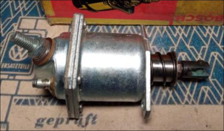

PostPosted: Fri Nov 07, 2025 10:54 am    Post subject: Re: 6v to 12v conversion Reply with quote
RCJH77 wrote:
What am I missing?
Is your 6V starter still the original Bosch unit that came with the car? That 6V solenoid in the photo doesn't look it belongs to the original starter from a '60 Beetle. Is that the one from your car?
I've also converted my '63 Beetle to 12V, kept the 6V starter, but swapped the solenoid for a 12V version. It looks like the one shown in your 2nd photo and it mated up perfectly with my original 6V Bosch starter.
This is what an original 6V starter & solenoid from a '60 Beetle should look like.

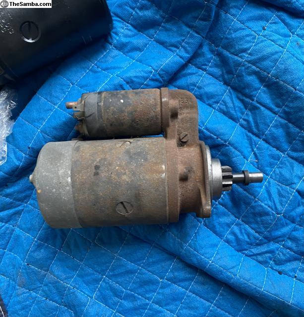

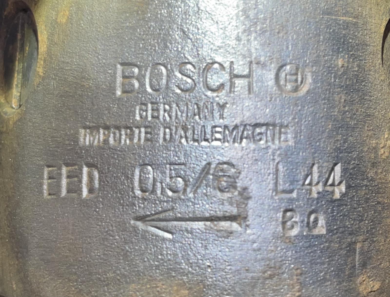

Good question. I had assumed so, but maybe it's not. Here's what I have and it matches the images from my Bentley Manual:

I think I'm just going to have to run it with the original starter and solenoid. I'd have to find a newer 6v starter and swap the solenoid or do the 12v starter and flywheel swap, which is more than I want to do at this point. It never ends.

PostPosted: Fri Nov 07, 2025 1:49 pm    Post subject: Re: 6v to 12v conversion Reply with quote
RCJH77 wrote:
That starter appears to be from the mid-to-late '50s...used on both cars and transporters.
Yours might be original to the car though...especially if it was a very early build for the 1960 model year. VW was in the habit of using up existing stock prior to updating with newer designs.

I think that's probably what happened. My car was built in October of '59.
