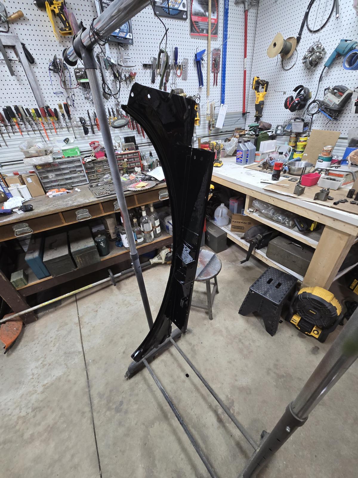

A couple coats of POR15 on the inside of the modified apron.
Hope it is dry enough to tape it off and paint the outside tomorrow.

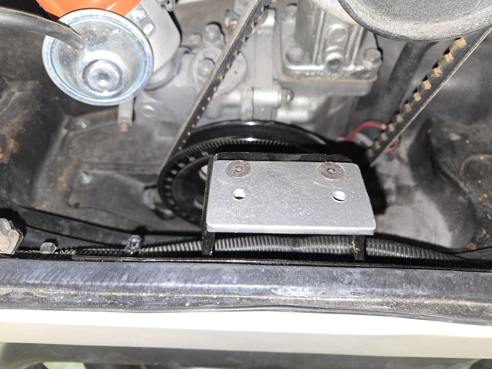

Good enough for this pile. The gap between the donor apron panel and the body is a little more than I had hoped but it is secure.
Of course I scratched the hell.out if it putting it on.
I had to make some mods to the latch/catch and am awaiting the arrival of a countersink so I can attach that.
As I said before, the car must have had a hard life.
The gap between the body and the engine tins on the PS is way bigger than on the DS. It was a bugger getting the engine seal in there in a way it will function.
I have yet to theow the afr on it since I replaced the exhaust. That is probably the next task while I await decent seat belts.

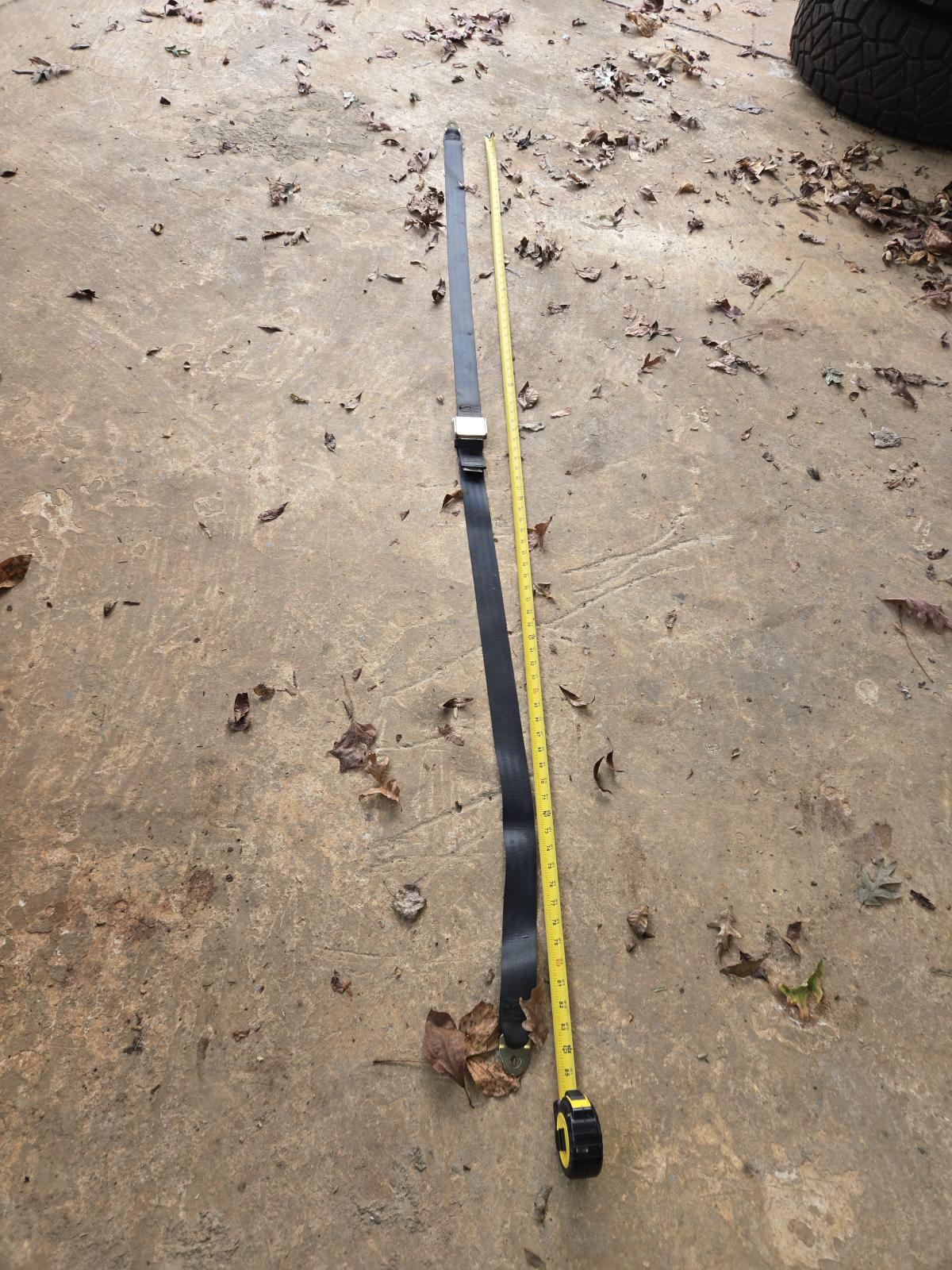

This is what was in the car for safety belts.
Anyone if you fat boys need a 7 foot seat belt?!
If anyone was using this they were not going to fit behind the wheel of any VW Thing!
And for sure 7/16-20 bolts in there. The DS was cross threaded.... of course Rolling Eyes

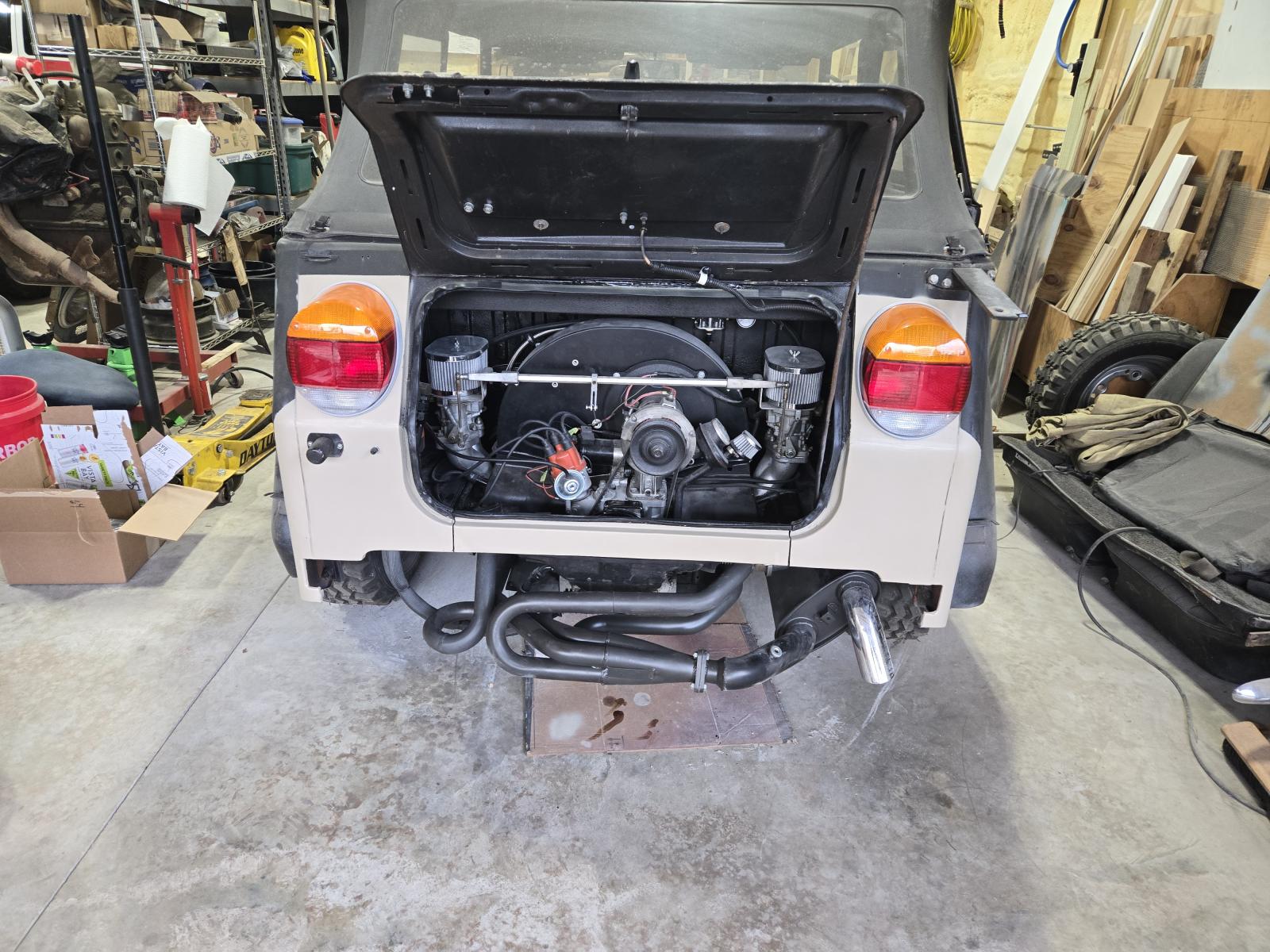

Pics of my latch solution. The countersinks I got from Bezo worked perfect.
Here it is closed and latched.
I did not realize how out of shape the decklid was.
It has been cut up on the inside too when the PO attached the swingout tire carrier.
I may hit Mike up for one since I will be painting it tan eventually.
Still, it latches great. Seems like the latch needs another screw.

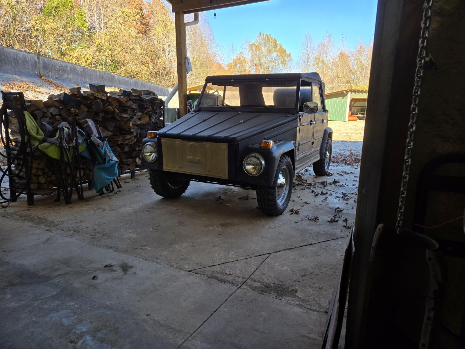

Went for a short drive today and temps were way down. Before all the repairs to the engine bay and new fan I could not eventouch the dipstick. Now oil temp seems to be right around 170F. Easy to touch the dip stick and pass it back and forth between fingers (the old temp test). Head tempnis way down as well. It does not smell super hot either. With a laser thermometer the case temp was about 163F. Dare I say my woes are no more?
