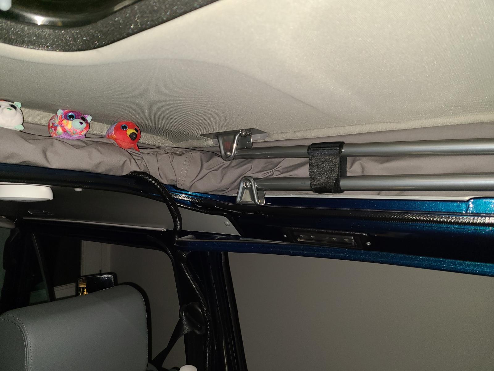

vanis13 wrote:
...is that a Velcro strap? What's it's purpose?
Possibly a 'belt & suspenders' approach to assuring the top stays latched?
Quick release nylon buckle strap, one on each side.
I hate Velcro.
vanis13 wrote:
What's [the] purpose?
Ahwahnee is correct. They're to prevent the pop-top from lifting in the wind and/or while driving. I've been doing it ever since driving east on I-40 over a decade ago with the wind raging, when I had to pull off due to chairs in the luggage bin getting blown around (not tied; just laying under a net). I noticed while parked on the off-ramp that the pop-top sides were lifting, just from the wind. Have never had the top break loose and pop up while driving (and hope to never have it occur). Can't say the same for my parents' '89; popped up on a windy trip through western Colorado several years back (and the top had been securely latched that morning). Ever since, Dad has put cam straps on... no reoccurrence of the incident.

The Bombay struts are a game changer - we roll our canvas - we used Velcro straps for a bit of peace of mind.

In my '86 with original tent, yes.
In my '87 with replacement tent and Bombay shocks, no.
In case anyone wants to do something to help keep their top from popping when underway, think over this (as far as I know, the PO's original and unique) solution.
The main points here are that there is a pin that needs to extend through the hand grip as the handles are pulled down. If this pin is blocked, there is no way that the pin can let go of the latched top. Yes, it is rusted, and I have not been too concerned, since it matches the rest of the '87's patina. It's never caused me a second's thought that it is ruining my camping, traveling experience.
BTW, Jack Bombay shocks are now sold by another reputable vendor. Them r good.
