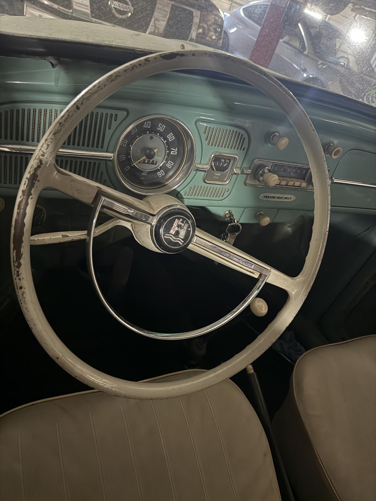

Did any of you did steering wheel refurbishment?
Fill cracks, fix the paint. That kind of stuff.

Yours actually doesn’t look terrible. Start by pulling it off and sanding, sanding, sanding. And for the worst cracks use some flexible filler / elastic Bondo type stuff. Sand that smooth’ish.

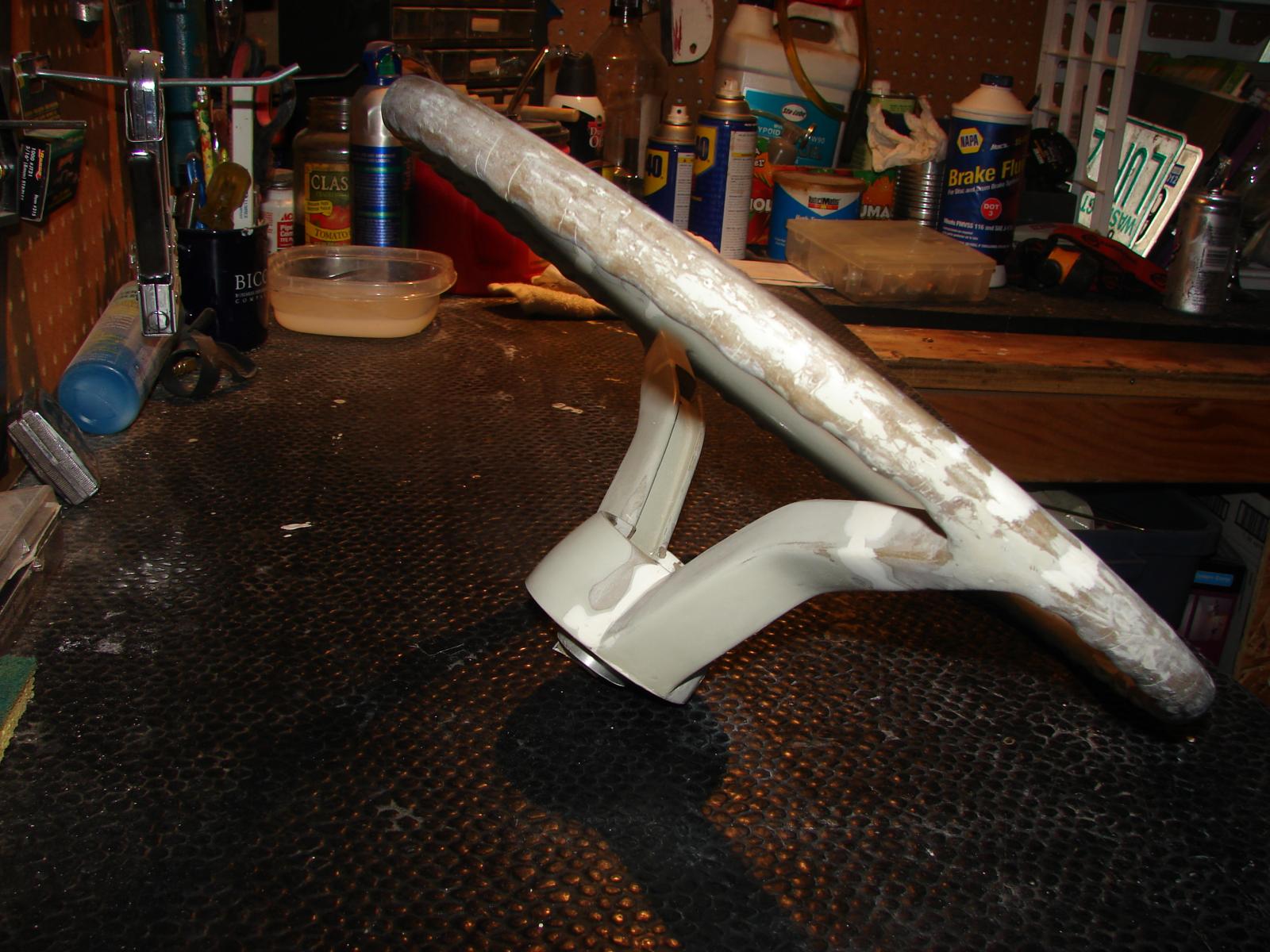

This is from my 64 but. I used bondo and the cracks came back within a year.

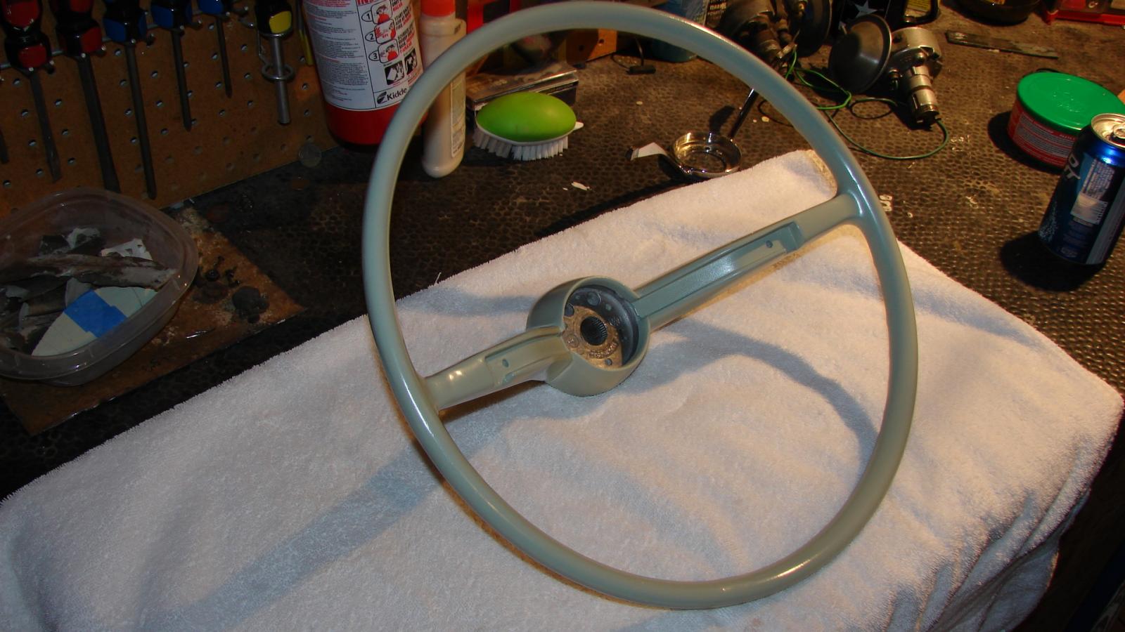

Great advice. I did mine following similar instructions, and used 2 part marine epoxy. My cracks never showed back up, even after 13 years. The weak spot is the paint finish, and my ring did mess it up. This was my first try, and I didn't get the wheel perfect. It's a 1960, so one year wheel. I did find an intact horn ring shortly after I finished repairing and painting the wheel.
This year I went ahead and sent it down to Koch's to be recast, and rechromed.
