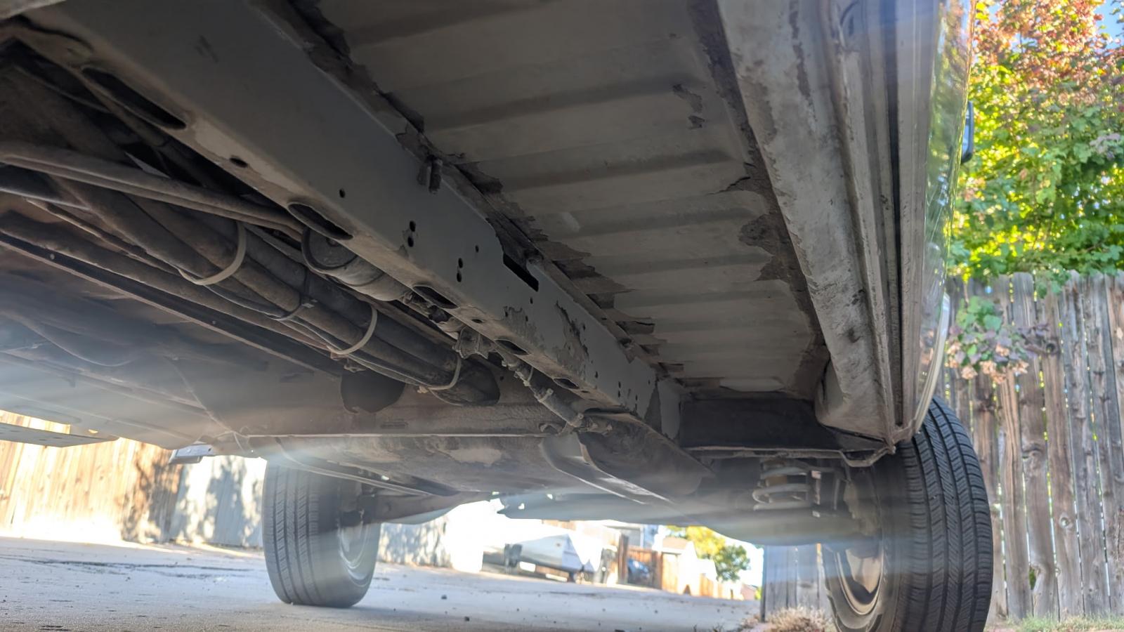

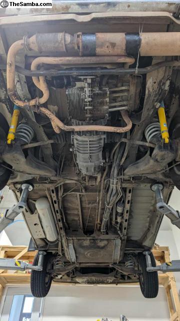

Here is the undercarriage
Good suggestion to save some money by doing as much of the grunt work myself. I'm totally up for that, and am just working with the handicap of shopping at a very long arm's length. This van is in Colorado. I had a pre-purchase inspection done today at a place that works on older VWs, and specifically asked them about that area, but they punted and told me to take it to a body shop.
I have a good place lined up here in Cincinnati when I do buy - Vogt Auto. I just need to get over the hump of a very limited selection of rust-free vans nearby or rolling the dice and buying one 1,000+ miles away.

You don’t roll the dice, you go see it and inspect it like any other. If you don’t have time to inspect and travel, then stay out of the Bus game.
That Bus will take $20,000 and consume it I a heartbeat and still be a POS

On my phone, the chassis looks solid from underneath. The sliding door takes about 5 mins to replace with a good used one. Seam rust is just one of those Vanagon things. The area above the r/r tire is one of those areas. You can access it from inside the van and slow the rust down without getting carried away. I’ve seen a lot worse rust buckets still be driven daily.
Certainly a pristine one may come along, but if it passes a mechanical and you aren’t looking for a trailer queen, based on price I wouldn’t walk away. I’m tripping over a solid side door from an 87 every day. There must be others closer to you.

It's difficult to understand where you're at w/out knowing your budget for the purchase plus post-purchase fixes. Unless the van is perfect expect $5K - $10K in corrections to deferred maintenance (fuel lines, brakes, motor, transmission, tires, etc. etc.) for just about any Vanagon. $10K or more for plenty of other Vanagons.
As for the van being well maintained, dozens of receipts won't reveal what a PPI will. At the least, you'll need a compression test, coolant system leak down test, etc. Check out the FAQs for pre-purchase checklists if you haven't already.
Happy shopping!
- Jim
Butcher wrote:
Guilty as charged.
zerotofifty
Joined: December 27, 2003
Posts: 4196
zerotofifty is offline
PostPosted: Mon Nov 10, 2025 9:44 pm    Post subject: Re: Paint cracking w/rust sliding door & wheel well: How bad is it? Reply with quote
Much of what I see is fairly good, looks to me the van was in a fender bender, and he bondo and paint repair is failing . As other suggested, do a magnet test. I am pretty certain they is bondo in the area mentioned, you needto do the magnet test on the rest of the body, if rest of body is bondo free, then this is not an issue of massive salt induced rust, as that problem will be all around the van.
You may remove the interior panel to see the extent of the denting from the inside to gage how much bondo there is
If price is right, this maybe good for you. If you is handy with basic bondo and spray pint, you maybe able to make this area nice for your needs.
The key is that you know if the rest of the body has damage or not, hence the magnet test. a rubberized fridge magnet works well for this test, slide it over the body all around, it should stick uniformily over the body, where it stick poorly, that is a sign of bondo. pay attention to the seams, not only with magnet, but also by close vision inspection, are seams uniform, not wavey, and such?
Good luck
