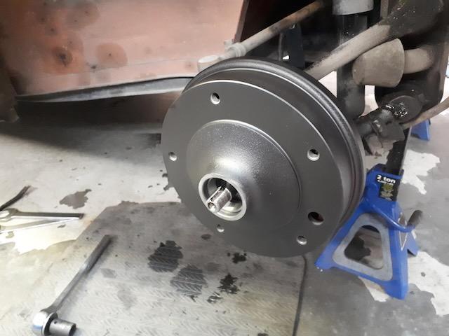

OK this will be wrapped and put aside just in case I sell the car and the new owner wants it
It fits! Phew!
It looks like this is going to work

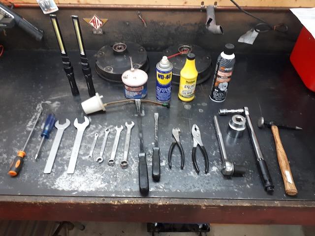

I used these tools to do the brake swap
Don
