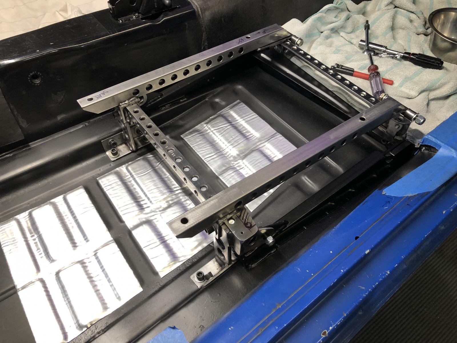

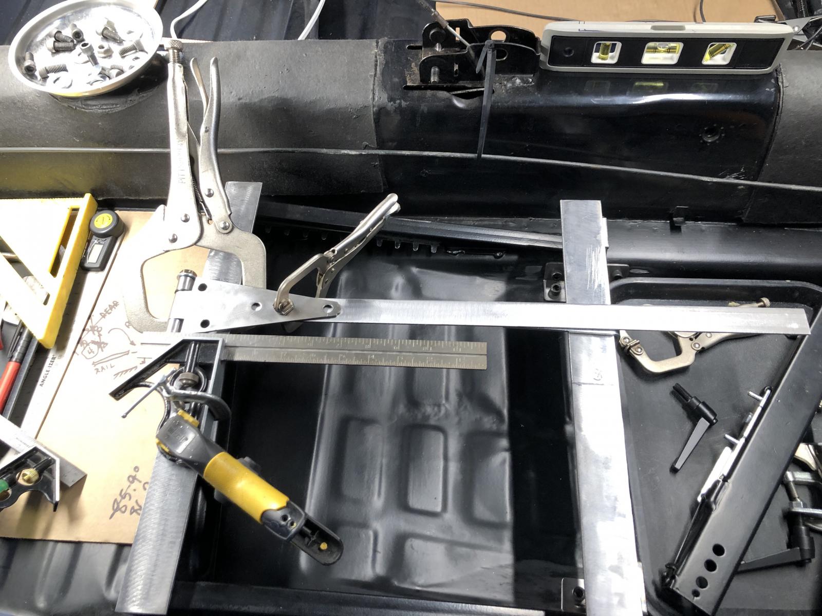

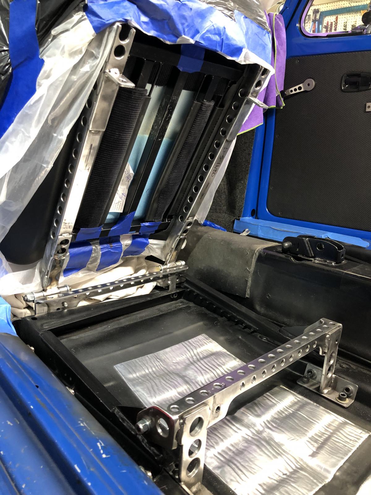

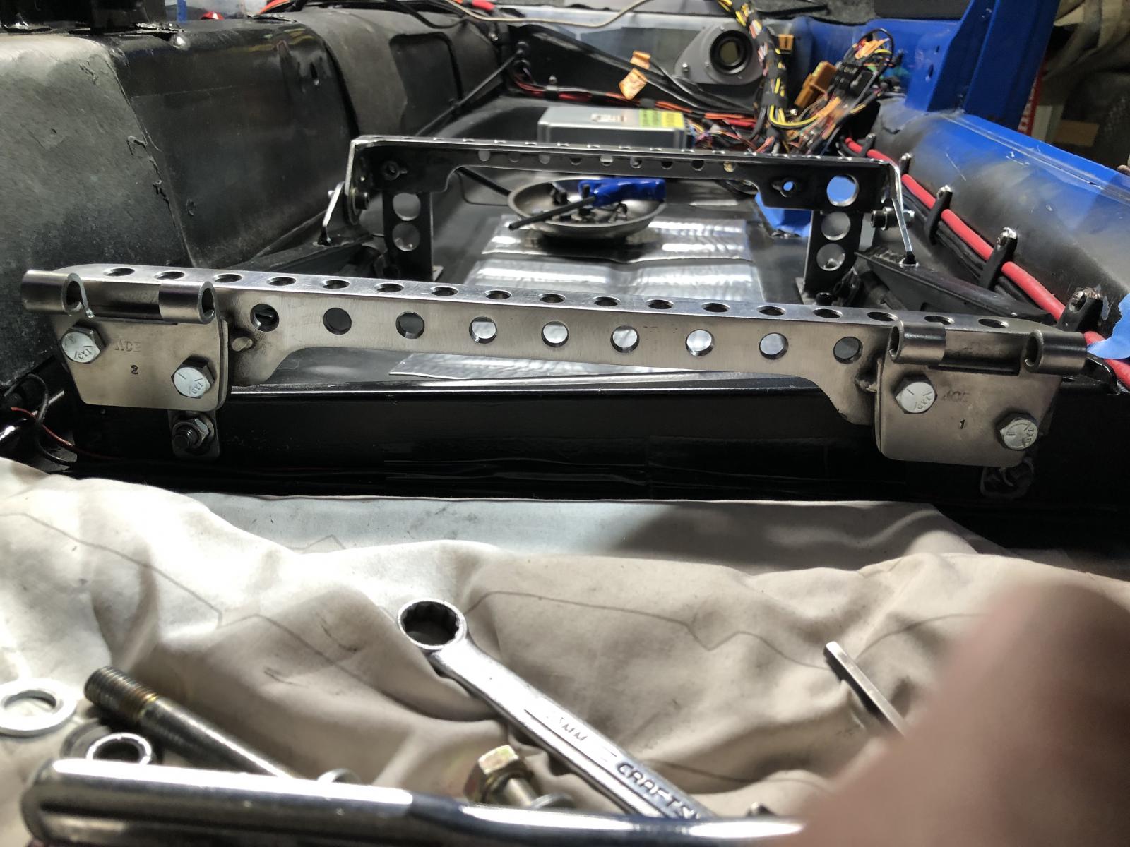

Speaking of solid mounted (no sliders) fixed back seats and roll cages…
I fabricated some custom hinged seat rails (solid mount, no sliders…too heavy Rolling Eyes) to work w/my seat mount structure…
Allows the seats to tilt fwd after removing 2 bolts from the aft side…
…which allows for ‘some’ access to the rear electronics and spare tire…
…although you still have to duck under the door bar! However, for out on the road, it allows for some relatively quick access. And if more access is required, the seats are light weight and easily removed w/tools to be carried in the ‘tool kit’.

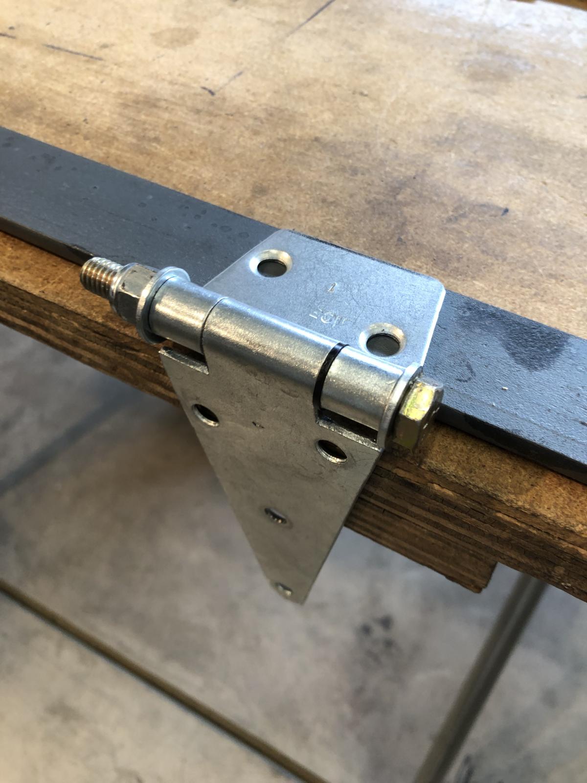

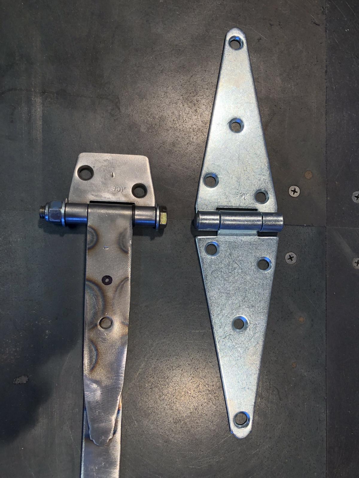

Made the hinge ‘mechanism’ from heavy duty gate hinges from ACE…
…welded closed the pin eyelets (to prevent deflection) and then reamed the hinges for 3/8” grade 8 bolts.
Early prototypes and proof of concept (with sliders)…
J.
