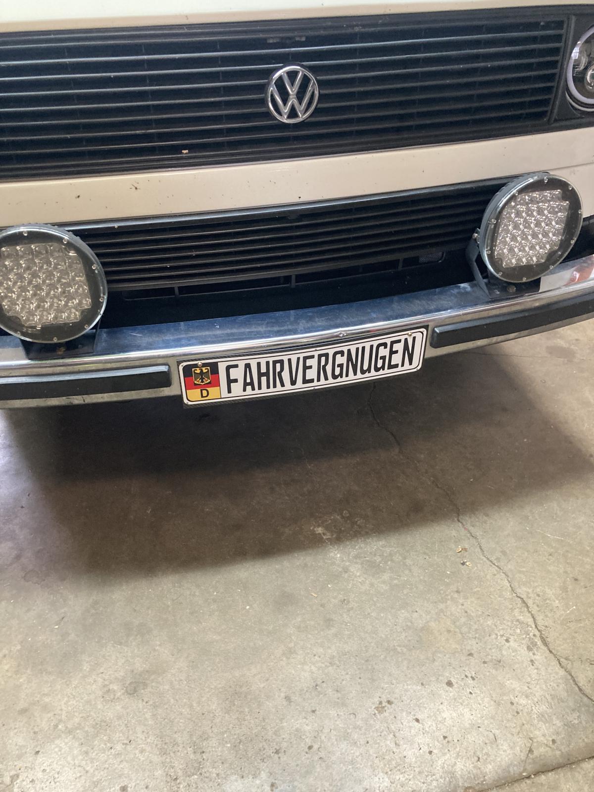

Got a fun euro plate knock off mounted

^^^ Classy!
You forgot the umlaut!

PostPosted: Tue Nov 11, 2025 8:26 am    Post subject: Re: What did YOU do to your van today? Reply with quote
Yeah wasn't an option with the online order form. Knew someone was going to point that out. Hell had to google just to spell! Embarassed Laughing

PostPosted: Tue Nov 11, 2025 1:04 pm    Post subject: Re: What did YOU do to your van today? Reply with quote
Kdj wrote:
Yeah wasn't an option with the online order form. Knew someone was going to point that out. Hell had to google just to spell! :oops: :lol:
Get some white paint to match the background of the plate and add a line across each upright of the U to make your own. You owe it to die Sprache.

PostPosted: Tue Nov 11, 2025 3:34 pm    Post subject: Re: What did YOU do to your van today? Reply with quote
For “die Sprache”. Thanks for pointing out the errors of my way!

PostPosted: Wed Nov 12, 2025 6:36 am    Post subject: Re: What did YOU do to your van today? Reply with quote
Yay! I did something similar for my VELO plate so it would have the correct accent mark. Diacritical marks exist for a reason.
