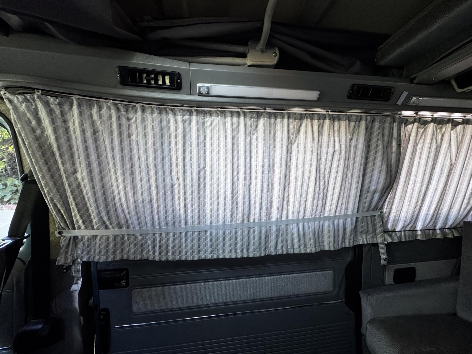

Sliding Door Curtain Retention
The Problem: The elastic at the bottom of the sliding door curtain has long since given out and the little rings at the bottom corners of the curtain are long gone. So, the curtain hangs into the living space (where inches are precious) and allows prying eyes to see in from the outside.
The Solution: An elastic strap with female end snaps installed at each end and then attached to the male end snaps that are available for use when the short curtain straps that retain the curtains when they are pulled open are unsnapped.
Simple, inexpensive parts from a Craft Store (in this case, Michael's)
Measure out a length of elastic strap, allowing for as much or as little tension as you want and install the snaps at both ends.
Pull the curtain closed and attach the elastic strap. Done!
