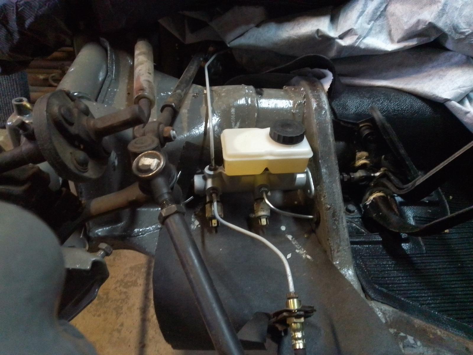

Bobs67vwagen
Joined: March 27, 2005
Posts: 877
Bobs67vwagen is offline
PostPosted: Fri Nov 28, 2025 12:44 pm    Post subject: Re: Rear Brake Line Reply with quote
I put one on my IRS pan that I am going to use on my 67. I got it form rock auto, here is a picture.
