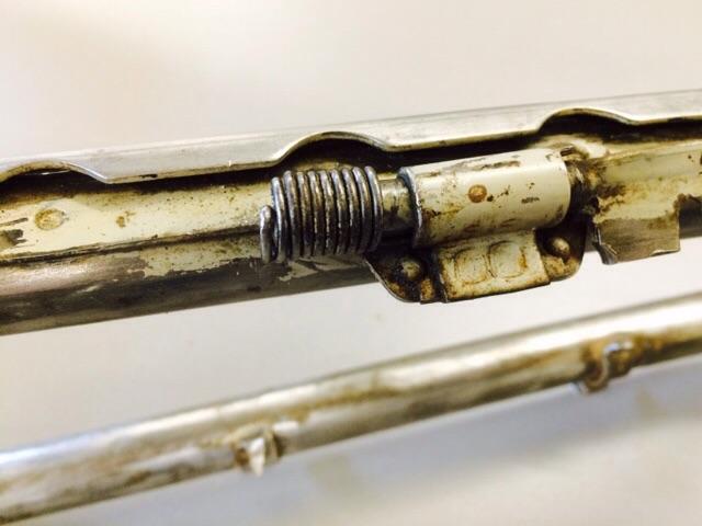

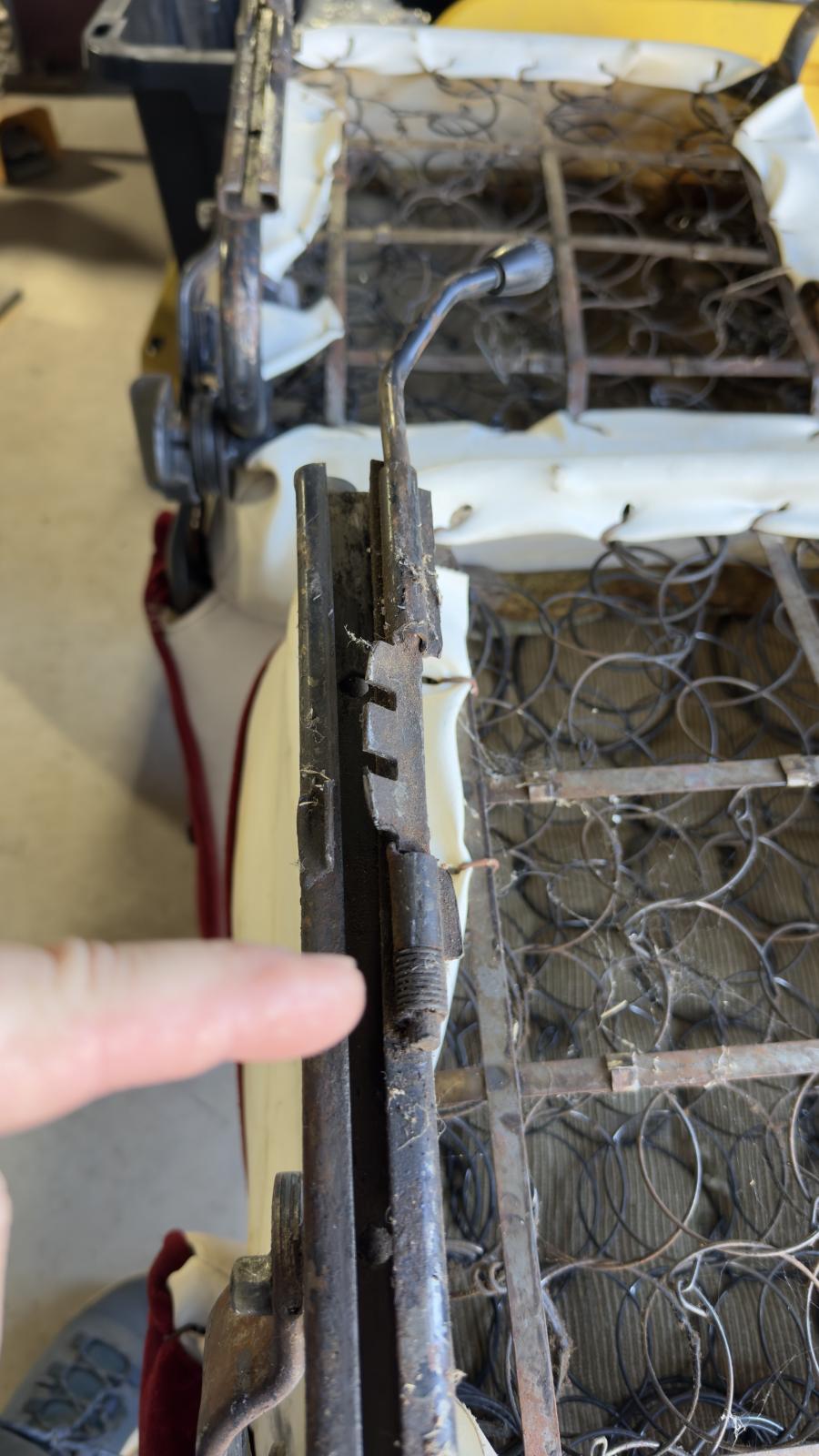

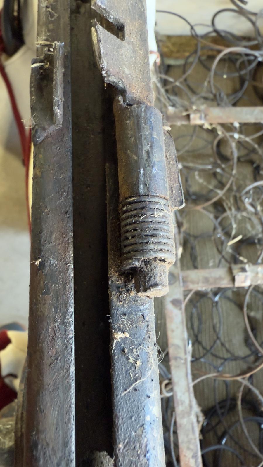

PostPosted: Today 10:56 am    Post subject: Re: Seat Latch Spring Reply with quote
Here are two photos of the spring. One end is straight and goes into the seat frame next to the adjustment shaft while the other end goes into a hole in the lever shaft.

daveblank is offline
PostPosted: Today 11:22 am    Post subject: Re: Seat Latch Spring Reply with quote
Thanks That helps a lot
