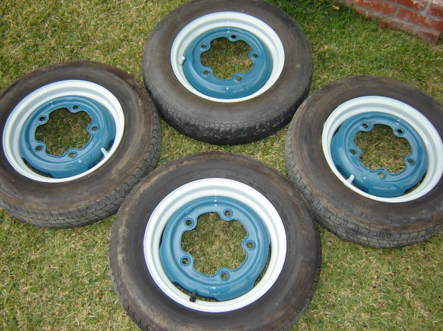

the pic below says royal blue, looks just like gulf blue to me Confused
Need to find the paint chip to see them next to each other i guess Smile

It´s hard to tell from the picture, but the blue on the rim is slightly darker than the body. It was hard to find a paint supplier that could mix the rim colors (kings blue and misty grey). But when you see the car irl with its correct rim colors it looks so much better than with gulf blue/pearl white rims.

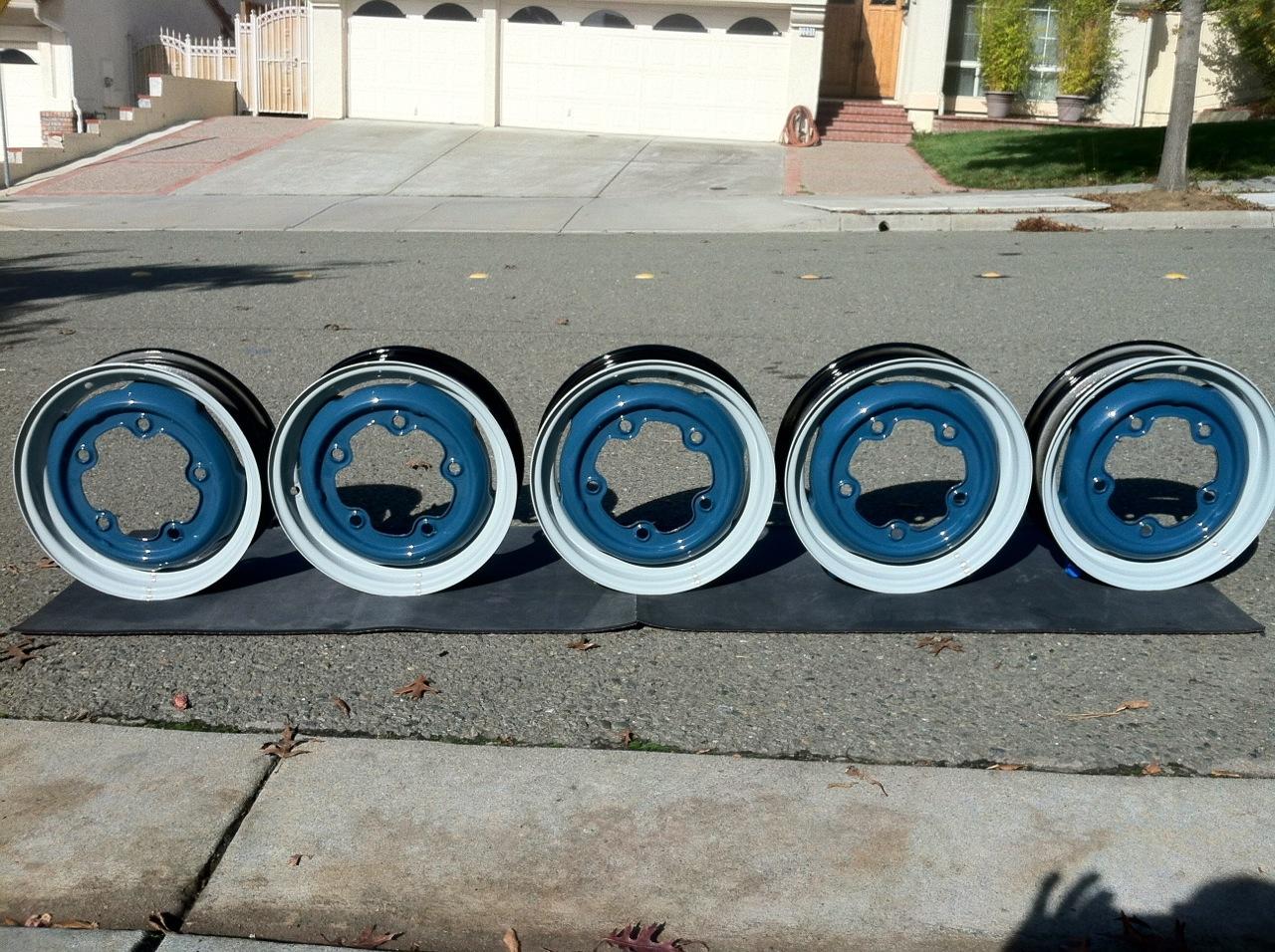

Freshly restored... These are M113's.. as painted by Bryan Nunes:

I was able to find the color code paint in a line by BASF. It is called Limnco and is a single stage and it pretty nice paint. I was trying to get Glassurit but they banned the 22 series in my area. BASF makes Glasurit so this Limnco line is there bottom end paint, but it is a thousand times better than PPG Omni, or DuPont Nasson lines.
