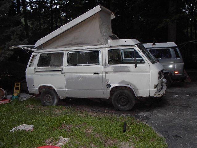

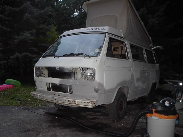

Paint is looking good...what's are the details on type of....gun......etc. ?

siphon cup,old emglo compresser set to 37psi, single stage "shop line" paint(pastel white) w/ water seperator. Nice day, low dewpoint,slight breeze. I'm just covering the primer at this point so I don't have to get to fancy with the paint atmosphere quite yet.
I just finished pressure washing out 20+ years of funk out of the carpets....nasty Shocked
