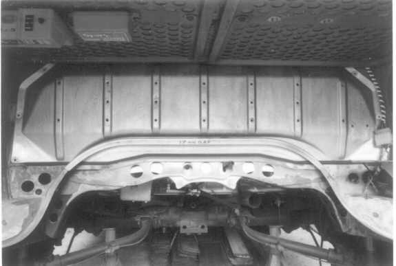

The engine bay of my British specification, 1973 VW "1600" Type 2 Kombi
Several years ago, whilst I had the fuel tank removed, I modified the removable, sheet-steel, fuel-tank compartment bulkhead (i.e. firewall in USA parlance), by welding onto the back of the seven ribs, a total of nineteen M6 nuts (two each on the two outboard ribs and three nuts each on the remaining five), to facilatate the later fitment of various components and accessories, such as an electonic-ignition control module and parts of a Bosch D-Jetronic or L-Jetronic, electronic fuel-injection system.
With the benefit of hindsight, it might have been better, to have fitted about five M5 nuts (in preference to the larger M6 nuts), to each of the seven ribs, to provided greater choice with regard to brackets and mounting.
The oil-bath air-cleaner mounting platform, associated with the VW 1600 Type 1 style engine, has been cut back (by about 1¼ to 1¾ inches, if I recall correctly!), to facilitate the use of a VW Type 4 style engine, with either twin Solex carburettors or Bosch D-Jetronic, electronic fuel injection, originating from a VW 411/412LE; the latter being the preferred option.
Two M6 screw studs have been brazed to the underside of the air-cleaner platform, to secure the alternator's remote-mounted voltage regulator, which would normally be fastened to the fuel-tank compartment bulkhead.
Note the trial fitting of a VW type 4 engine carcass (i.e. empty crankcase, plus cylinder barrels & heads), with cooling-fan housing, coverplates and part of the Bosch D-Jetronic fuel-injection system.
Home-made GRP and aluminium mounting brackets, for the Bosch fuel-injection pump and fuel filter, located beneath the fuel-tank compartment. The transaxle support bracket and adjacent bodywork, has been modified to accommodate the throttle-cable rerouting, for the fuel-injection system, throttle body.
