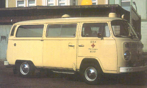

I've never really understood, why 1968~79 VW Type 2 owners, refer to as "ambulance fans", the intra-duct, electric ventilation-booster fans, illustrated as Item 18, on Page & Frame 104-00, of the official 1968~79 VW Type 2 Replacement Parts Catalogue & Microfiche, shown below!
What I think of as "ambulance fans", are those mounted in the roof, illustrated as Item 17A, on Page & Frame 104-00, of the official 1968~79 VW Type 2 Replacement Parts Catalogue & Microfiche, shown above. They are also featured in the following pictures, of a German specification, 1978 VW 2000 Type 2, Red-Cross ambulance:
The ambulance also featured an automatically deploying, sliding-door, passenger step and roof-mounted, rear, supplementary, turn-signal & hazard-warning lamps.
The pictures originally featured in the following four-page magazine article:
David Eccles, "Krankenwagen To The Rescue!", Volkswagen Camper & Commercial, Issue 8, Autumn 2002, pp8~11.
http://www.volkswagencamper.co.uk
However, these roof-mounted ventilation fans, are not exclusive to ambulances. I vaguely recall having seen them on German civil-defence and disaster-coordination vehicles, which I think also featured in various issues of Volkswagen Camper & Commercial magazine.
