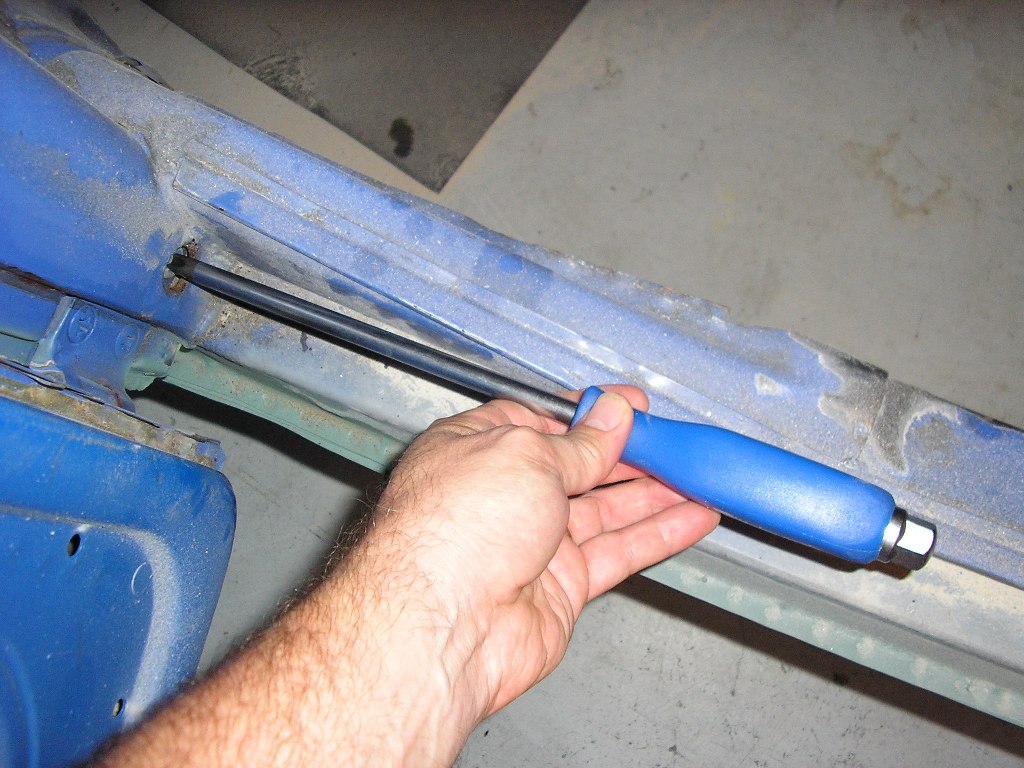

For what it is worth, the screws from my two Super Beetles were #4 Phillips head.
I found a useful set of tools at Harbor Freight to help with removing the doors. It is a set of Pittsburgh screwdrivers that have socket-sized attachments on the end of the handles. (See photos.) It makes quick work of getting those fasteners loose.

Seriously though, the manual Craftsman impact driver worked for me and the HF method looks good as well.
