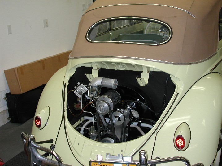

I would say "don't do it", very expensive convertible only W-deck lid
is not worth chopping.W conv deck lid rain catcher are non-removable.
we all know Conv W deck lid is much more expensive than Judson kit.
another issue is not just a deck lid but license plate light (threaded stud)
must be grind off about 3mm. otherewise judson pulley might hit.
we went far as grind few mm off the judson air cleaner.
here is our convertible with Judson supercharger, we didn't like Judson.
so now sports a OMT built Auto Teknik motor & W-conv deck lid.
before:
I will post after photo.
Take Care
Roy Very Happy

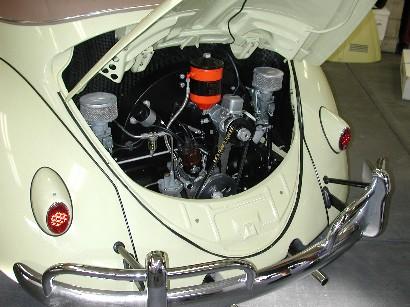

Judson built by famous engine builder in Orange county CA & Auto Teknik
was built by Al /AKA:OMT: we love OMT motor much better.
current:

PostPosted: Sat Nov 24, 2007 2:10 pm    Post subject: Re: Judson Supercharger on convertible ? Reply with quote
roy kohrogi wrote:
JP38 wrote:
Hello,
Is it possible to put a Judson Supercharger on 55 convertible ?
I don't know if it's possible cause the rear hood is different (behind the two air intake vents).
Thank you in advance Very Happy
before:
Take Care
Roy Very Happy
