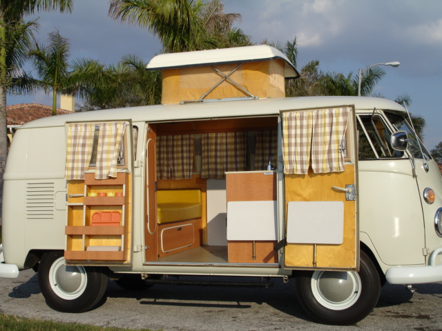

PostPosted: Thu Jan 31, 2008 5:11 pm    Post subject: Reply with quote
today for my westy's 41st birthday- i waxed, polished, detailed and did all the rubber care. took her for a drive a did a little photo shoot. just turned over 64k miles.
happy birthday to my bus- 1 year older than me. but in alot better shape... Wink

PostPosted: Thu Jan 31, 2008 5:16 pm    Post subject: Reply with quote
[img][/img]
Your Westy makes me hate my Westy. Crying or Very sad

PostPosted: Thu Jan 31, 2008 5:27 pm    Post subject: Reply with quote
///Mink wrote:
[img][/img]
you got nothin to hate about- Very Happy
happy birthday to my bus- 1 year older than me. but in alot better shape... :wink:
Goddamn I love that bus. If you ever get tired of it sell it to me.

PostPosted: Thu Jan 31, 2008 9:24 pm    Post subject: Reply with quote
^^ thanks Greg!! Smile
