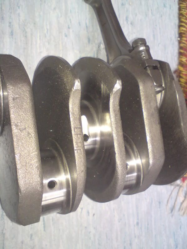

just bought an 78,4mm crank also with lepe and INPAVI markings...
does anyone know more about those than 3 years ago?
are you really sure, that it is a cast crank?
cheers
max

rote baron
Joined: June 15, 2008
Posts: 31
Location: Stuttgart, Germany
rote baron is offline
PostPosted: Tue Jul 29, 2008 12:28 pm    Post subject: Reply with quote
there is neighter a parting line like the forged one nor one that looks like cast. material looks more like the forgend one you have posted..i am gonna do better pics tommorrow...

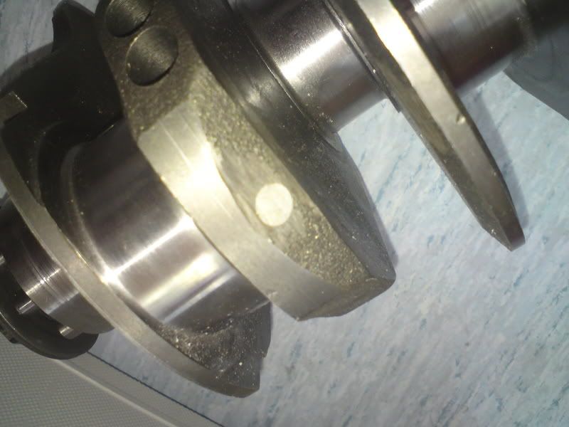

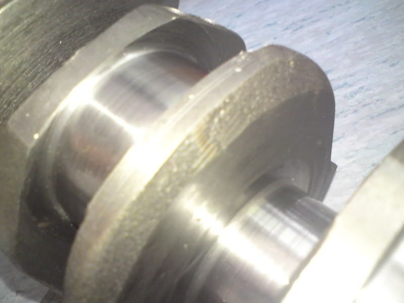

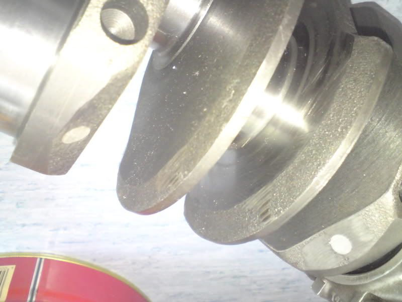

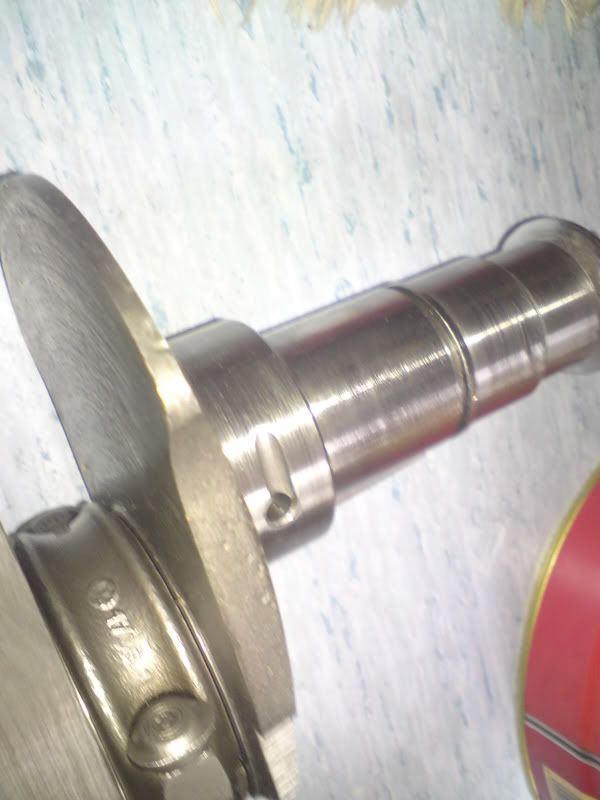

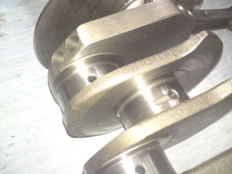

rote baron
Posts: 31
PostPosted: Wed Jul 30, 2008 1:04 am    Post subject: Reply with quote
hey guys thanks for your help.. it rings so it might be forged..
here are some more detailed pictures...

rote baron
Still not a good enough picture to see where the parting line might be.
Take one like the very first one I posted with the thin line.
I'm still thinking yours cast with those ID markings.

rote baron
Posts: 31
PostPosted: Wed Jul 30, 2008 8:54 am    Post subject: Reply with quote
there is no parting line to see.right in the middle the crank is grinded or something. you can see it on the pictures. bur the material looks more like forged but the signs seem to say it is cast
