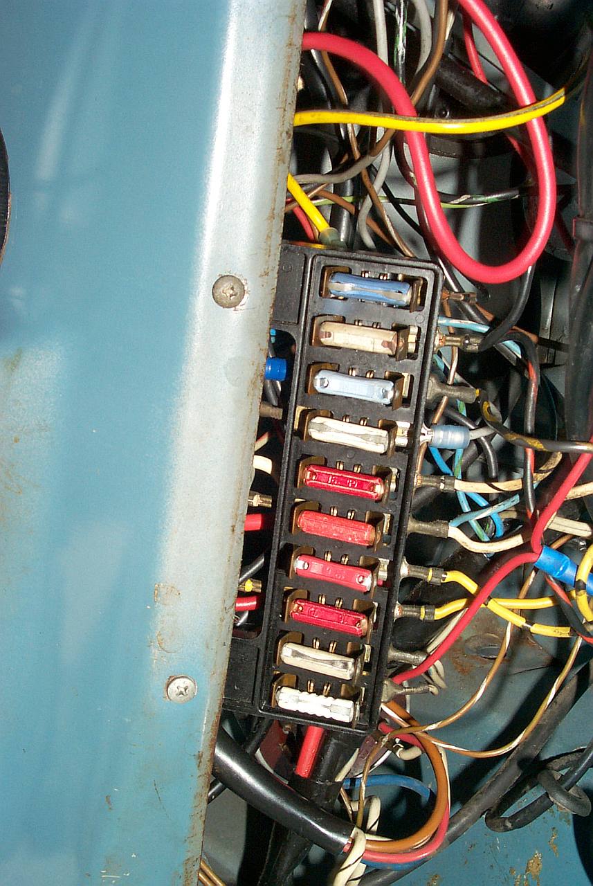

That was me several years ago. This is what I had:
It was a 12 hole fuse box from a later car. Things were plugged randomly onto it. I went down to Kinko's, pulled up these three items:
http://www.thesamba.com/vw/archives/info/wiring/type3_1500S_64.jpg
http://www.thesamba.com/vw/archives/info/wiring/type3_1500S_64_fuses.jpg
http://www.thesamba.com/vw/archives/info/wiring/type3_1500S_64_key.jpg
printed them out in color and laminated them. Then I did as Jason suggested and lay down in my car. It took me about 4 hours of tracing and running wires and I got everything hooked up. I feared the job for months and didn't do anything. I tried to get a couple different local guys to do it for me. I'm glad they refused. It's not as hard as it looks at first.

PostPosted: Tue Sep 30, 2008 10:37 pm    Post subject: Reply with quote
wiring pic
remove the battery! (you will want to clean that area and paint)
and you want the wiring to be dead(fried wiring sucks)
drop the fuse "box"
remove the pushbutton box
study the above wiring pic
trace wiring as needed
these photos I took, while working on daves 62 notchback
Roadster Bus
Posts: 71901
PostPosted: Tue Sep 30, 2008 11:26 pm    Post subject: Reply with quote
Don't duplicate the fuse colors seen above. There shouldn't be any blue fuses and a bunch of the others look wrong too. The wiring diagram or owner's manual has the correct fuse ratings for each spot.

PostPosted: Wed Oct 01, 2008 2:11 am    Post subject: Reply with quote
d'oh!
you are right, all the fuses should be 8 amper/amps, white in color.(1962-3)
I will repair that, once dave gets the notch back, from jimmy,
