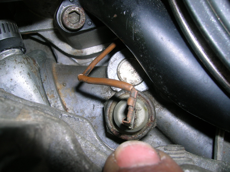

Id, i see on one picture that you didn't change the oil pressure sender in between the pushrod. Please do so... those fail dramatically, they can start leaking badly in between the plastic part and the eletrical connector. Worse, they still work so wile the engine is bleeding to death, the light stays OFF. Many engine have died this way! You can empty the engine (oil) in about 5 miles.
Ben
http://www.benplace.com/oil_pressure_sender.htm
Working with rust, grease, dirt and dust is a sad truth.

Thanks for the tip about the oil pressure sender. I'll have to order one up...

Take Ben's advice, though. It's a very good idea to replace both OP switches before they start leaking, and to be assured that they open and close when they're supposed to.

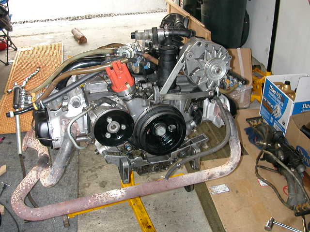

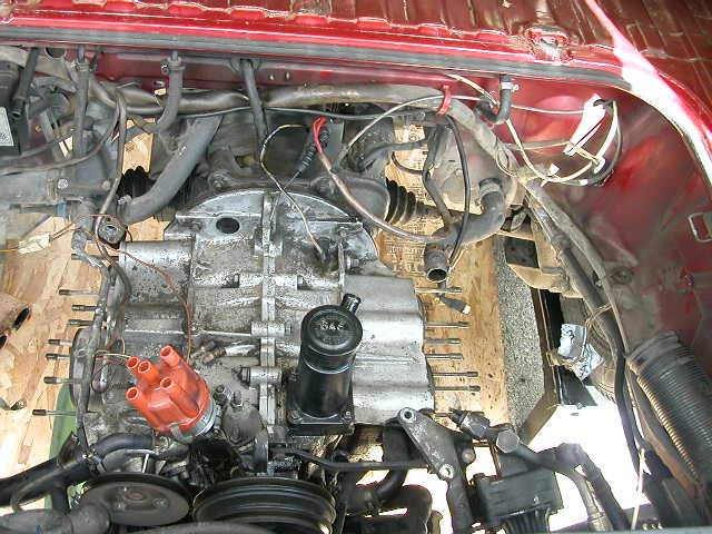

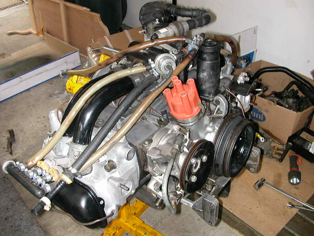

I'd like to give a HUGE thanks Id. This past Friday I got back my rebuilt 2.1L long block and this is my first engine rebuild. The whole weekend I have had the Bentley book and Samba on my laptop side by side and have used your thread the most. I just got it all connected and tomorrow I'll turn the key and hope for the best.
Here are a few pictures from Saturday and Sunday. I'll post the rest a little later.
And thanks tencent for all the priceless information!
the engine stripped.
and back from Northwest Connecting Rod....thanks Jerry!
another shot of it dirty
cleaned up with the intake on (all new fuel lines and water pump)
and a shot with the alternator on
I got it back in the rig tonight and hooked up electrical, coolant hoses, power steering pump.
Tomorrow I'll get the exhaust completed, fill it with oil (Royal Purple 20-50), fill it with coolant, and start 'er up!
I made up the coolant bleeder tube that Andrew Libby designed and try it out tomorrow.
So thanks again for the great thread and all the pictures, They helped me immensely!

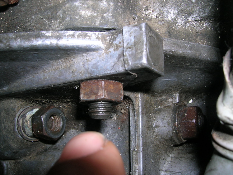

Here are some action shots from the final re-assembly this weekend, in case anyone is interested, or finds them useful...
Shot of a top trans-block connection bolt. Had no washer. Is this normal?
The electrical connection at the bottom rear of the engine
And the one on the bottom left side
WRT the washer on the engine mount bolts: no,not correct; they always have wavy washers when new.

BTW, VERY nice pictures. I especially liked the above one of the rear HP oil pressure sensor. How did you take them? Camera, settings, etc.

Thanks for the information. I'll get some wavy washers for the trans conx. The Green Dragon is going to the vet tomorrow for a final check up. Hopefully a simle timing adjustment and we are on the road.
