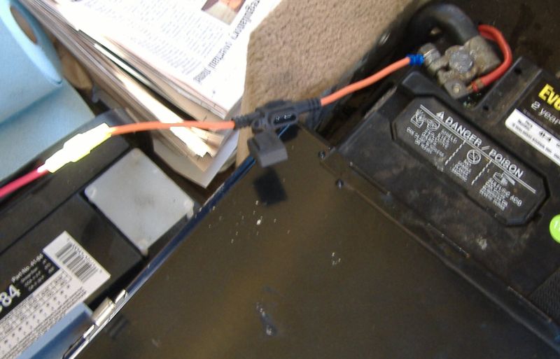

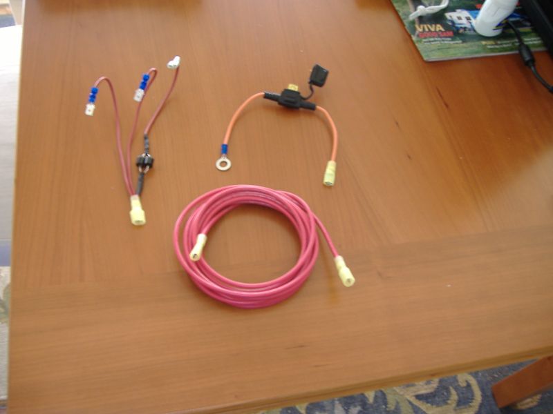

Here is a wiring tool that bypasses several of the wiring faults I have seen in various vans, mostly 2.1 wbx models. It is meant as a driveway testing tool when trying to isolate a won't start or won't keep running problem. Many other things could cause such symptoms and this won't help with them but at least it is an inexpensive way to reduce the possibilities.
It consists of a long fused wire connected to the battery positive terminal. The other end splits into 3 separate leads, each to be connected in a certain spot to the fuel injection/ignition wiring. With this installed the engine will run even if the ignition switch is bad, or the FP or ECU relays are bad, and even if a bunch of other wires or connections are bad. If it starts and runs after this tool is installed you have then eliminated most of the expensive stuff as possible causes.
The 2 male spade ends plug into the ECU and Fuel pump relay sockets, where leg 87 of each relay would have gone. The diode protected female end goes to the empty + post of the ignition coil where there are usually 2 black wires also.
The fuse is 20 amp, the long wire 12 gauge ten feet. The short wires are 16 gauge so all 3 can be fit inside one crimp connector meant for 10 gauge. The diodes are from Radio Shack, #276-1661 pack of 4. The 2 diodes are in parallel with their marked ends pointed away from the 3 wire crimp. The diodes are there as a one way valve of sorts, to let the jumper power the coil but not let the coil power the jumper. This is important to prevent vehicle wiring damage as the jumper would otherwise possibly allow higher loads on wiring not meant to carry them.
Put the fuse in after everything else is connected. The fuse acts as a switch to turn every on/off. You must pull the fuse to stop the engine after it is started. The key is still used for starting but won't stop the engine with this tool connected. You need to pull the fuse out when not running the engine! The fuel pump will run constantly and the ECU will be powered up along with other FI components until you pull the fuse. Do not plug or unplug things with the fuse in or the key on.
This tool is meant for driveway type use, not for driving! Use at your own risk. Don't leave out the fuse or the diodes! If you don't want to build it right, you probably shouldn't do this at all.
If your engine starts and runs with the tool when it would not without it, you can know the fuel, fuel filter, fuel pump, fuel pressure regulator, injectors, coil, dizzy, sensors, AFM, etc were NOT the cause of the problem. This leaves a wiring problem as the most likely fault. By removing the 3 jumper ends one at a time and putting in the relays as you go you can narrow down where the wiring problem is. DO NOT plug or unplug any of this with the fuse in. Take the fuse out, do your thing, then put it back in to check the result whenever you are changing something.

thats really cool, you didn't mention how long the long wire needs to be? I love the inginuity.

why can't you grab +pos power from right in the engine compartment?
from the lug in the little black box?
from the back side of the Alt?
I too have often bypassed many of the stock systems. \with the primary question, just what does it need to start/fire/run?

You can, but that is part of the vehicle wiring that often fails and that this long setup bypasses. That is also part of why the long wire is detachable from the shorter pieces. The piece with the ring terminal and fuse holder can be moved from the battery post to that power post in the engine wiring box and the the 3 wire section plugs right into it. The ring is too big but can still work there.

if yer not getting a good or least decent +Pos on the back of the Alt then the rest of the system is the least of your troubles..
the Alt +pos connects directly to the Starter Battery cable then directly to the +pos battery side.. so it's essentially the same circut track as adding a +POS lead to the battery...
but I don't want to dissuade this any, it's handy to know where & what to hook to eliminate the key & relays..
in fact I have an Audi 5000 turbo dead in the yard with a new Ign switch just came in.. that fueling & wiring system is a pita..

The wiring you describe changed a few times over the years. In any case I have seen several times where the wire from the alt to the starter cooked internally and made a poor connection. The last time on my friend Brian's 87 Syncro the voltage was fine when measured with the key off but would start to drop out when the key was on and disappeared entirely while the starter cranked. I did not need this bypass tool to find his problem but the tool might help someone who did not know what to look for. That is the whole point of it , bypass many known problem areas in one step. If it fixes the symptom, then you break it down and look at smaller sections of the wiring. It the longer setup does not help, you know to look outside of the bypassed wiring sections. Divide and conquer.
