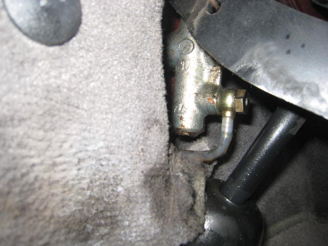

I've noticed my brake oil level was getting low too soon after fill up. I looked around under the reservoir and found where the leak was happening. Can you tell me what gets wrong with this unit usually so I can check on it? This unit is located right behind the brake pedal as you can see in the pictures. Thanks in advance.

That's the clutch master cylinder, if it's leaking you replace it.

It's hard to tell from the pics exactly where the leak is coming from. If it is coming from the boot on top, then get another clutch master cylinder. If it is leaking from that fitting then the fix could be as simple as a new copper washer on either side of that banjo fitting. Clean that area and watch while the clutch pedal is depressed.

I checked to see where it s leaking. It doesn't show in the picture but there is a rectangular box thingy above the clear hose. Looks like two bolts are holding it and the bottom bolt is squirting the oil out when I pumped the pedal.

If I'm not mistaken, then the two left bottom holes simply mount the clutch master. The bottom right is the banjo hyd connection and the top rubber fitting is where the fluid enters from the reservoir. I'm pretty sure the two mounting holes were blind and didn't enter the hyd area at all. If you think the fuel is coming from the bottom of those holes, I would clean it off thoroughly and check again. Perhaps it is leaking from the boot area in a non-visible way and collecting at the bolt.

Is it dripping or squirting? If it is actually squirting around a bolt hole then there is a crack or casting flaw and total replacement would be the only option. Replacements are available through many sources.

I checked again. It was very hard to see upthere from the pedal area but found the leaking hole on the boot. oil pumped out of a small hole on the boot... what to do now? replace the whole thing?

Since you don't seem real familiar with this part of a car, you would probably be way ahead just to order and install a new master cylinder. Swapping them out is very easy, takes little time, and only a few tools.

Yes, new clutch master is in order. You'll also want to bleed the system of air after replacement.
