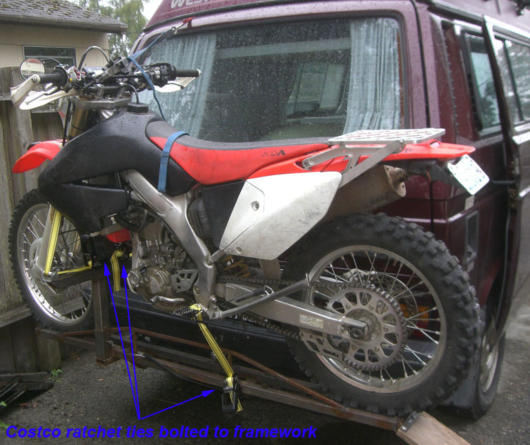

Here are some photos of my motorcycle carrier. It was used many thousands of miles on a 2wd westy, and more to come on a Syncro. It's homebuilt, obviously. I'll paint it someday. Stock springs. the bike in the photo weighs 270 lbs. Other bikes I've carried (XR600) weigh 300 lbs.
With the strap going to the hatchback hinge it's rock solid, no movement. The vans headlights point up a bit.
Putting the bike on is easy, one person I roll it up a ramp then hang the top strap (from the hinge). Then I drop the "T" section in, just behind the front wheel. The ratchet-tie to the footpeg is angled back slightly, so when tightened down, it pulls the tire against the "T". The T is pinned in place with a spring-pin (in photo there is a bolt+nut) and then the ratchet ties pull each forkleg down (at the triple-clamp).
I have a trailer too and when carrying only one bike,,,,of course it's nice to have it on the back. I have a brakelights harness that I velcro to the motorcycle wheels.

PostPosted: Mon Jun 01, 2009 9:06 pm    Post subject: Re: Hitch-mounted motorcycle rack? Reply with quote
Sodo wrote:
I'll paint it someday. ................
It slips into two sockets for rigidity.
And it's painted, finally. After thousands of miles, many weekends of dirtbikin' and 3 years of modifications, for faster, better, easier, more ground clearance, the design has settled down for PAINT. Also for the rust to etch the steel so the paint would stick better Wink .
The Black parts on the ground weighs 28 lbs.

That was not strong enough, well, it was rocking to much so i modified mine to that:
The yellow arrow shoes what was added to reinforce the ramp:

That was not strong enough, well, it was rocking to much so i modified mine ------ Ben
Hi Ben,
Very nice, saves a lot of time by buying something already made, and improve it as necessary. The Aluminum looks lightweight, which is more important than you might think, you will be thankful as time goes on. Especially when you have to put the thing inside your van it reduces the risk to the cabinets. I have a friend who made a heavy one. He is SORRY.
I had a hard time getting rid of the "front-back slop". I found that I had to 'take it up' by pulling the bike toward the van with a strap at the top (to the hatchback hinge). This carrier in my pictures above, is the 3rd iteration. I tried each time to eliminate the strap at the top. Each time it came back.
Tom
Yea, the ramp was 200$ or so, very light aluminum ramp. But it was rocking to much (left-righ-up-down), the total weight now must be around 60 pound + the Sherpa at 250 pounds.
I will also add 2 security strap on each side for long trip, i made special ratchet tie that hook to the roof/pop top hinges and to thew bike.
Just for safety...
How much does the part that comes off weigh? ie the parts that you have to carry up to the van, prior to loading a motorcycle?
....KTMs, GasGas, SPOT mtb
ftp2leta
Joined: October 11, 2004
Posts: 3271
Location: Montreal
ftp2leta is offline
PostPosted: Tue Jun 02, 2009 5:32 pm    Post subject: Reply with quote
Sodo wrote:
About 60, if you mean the ramp/hitch.
Maybe 70, not sure.
Maybe 70, not sure.
Ben
Hi Ben,
60 lbs seems like a lot! If each time you have to carry 60 lbs to the van, then attach it,,,,, I think you will not be happy.
Are you sure that Aluminum part weighs 60, 70 lbs? (~20% of motorcycle weight)? (It looks like ~18 lbs to me)
Tom
