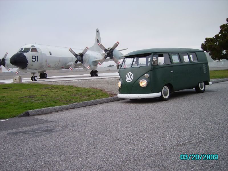

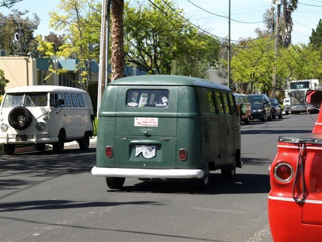

62Baido
Joined: January 18, 2007
Posts: 140
62Baido is offline
PostPosted: Wed Apr 29, 2009 2:08 pm    Post subject: Reply with quote
oring71 wrote:
Thanks for the reply sled,
Im trying to find some pics of any bus lowerd 2splins running RGB's but cant seem to find any, (maby cos as you said,,,its not such a good idea).
Eric.
Here ya go! 2 splines out back with small nut rgb.
However comma I will be raising it one outer spline back up soon.
