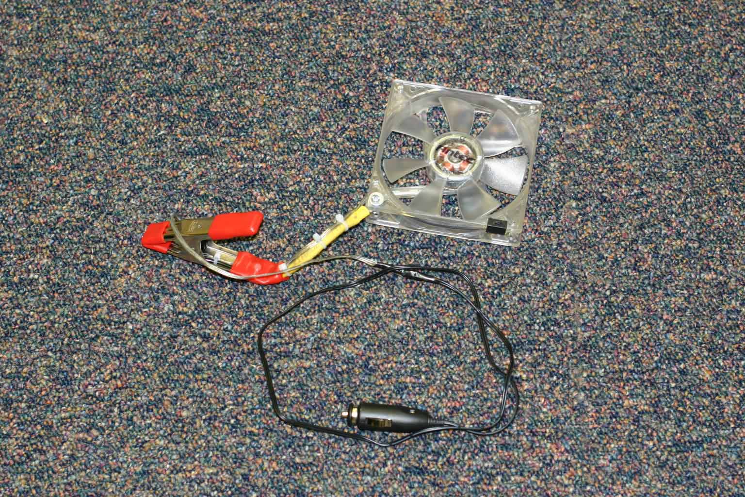

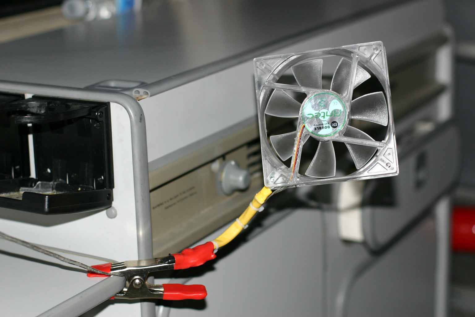

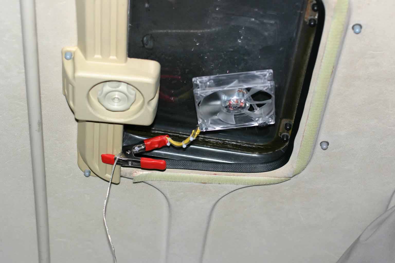

PostPosted: Sun Aug 30, 2009 9:44 pm    Post subject: Reply with quote
So, after reviewing nicro vent I decided to make my own fan. 120mm computer fan gives 80+ cfm for a few bucks vs 10cfm nicro. Plus I don't have to drill a big hole in the fiberglass top. I gathered pieces from my tool box and came up with this fan with flexible neck. I can clamp this on the top vent or windows and blow out the hot air during the day time when I m working or use it to blow at me or kids to cool down. Since I have 12v outlets everywhere in the van, I can mount this anywhere I need. I tested this fan all day long with the fastest speed( it has 3 speed settings) today and it only used .2 v out of my 2nd battery. Since this van is my daily driver I don't worry about draining the battery. I am going to make afew of this and place them different places in the van.

Hey targis, nice idea. I was trying to figure out something similar with a computer fan.
Mind if I copy? Confused
