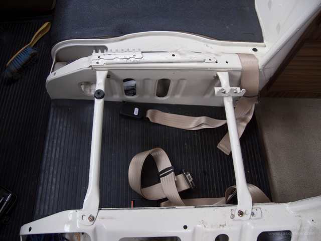

You need M501. An optional extra kit by VW.
M-Code
M500 = Full width metal partition between cabin and load compartment - bus model types 21-23
M501 = Two-person passenger seat instead of single passenger seat in cabin, spare tyre in left side of luggage compartment (not with M500) - bus models 21-24
Source: VW Transporter and Microbus Specification Guide 1967-1979 (By Vincent Molenaar and Alexander Prinz)
To see what this means, go to the Baywindow "Rarest of the Rare" thread and Jasonbye and cdennisg's posts. No welding here!
Here are some links and quotes:
http://www.thesamba.com/vw/forum/viewtopic.php?p=3702663&highlight=bench+bulkhead+seat#3702663
http://www.thesamba.com/vw/forum/viewtopic.php?t=1...;start=220
jasonbye wrote:
I've finally got my seats back from the trimmer so have fitted the M501 Walkthrough Bench Seat Option today.....
cdennisg wrote:
Sorry for the crappy pics but the bus was full of stuff. Eric (long-roofs) tells me this was to allow a 2/3rds bench seat to be placed in a walk through bus. So far only seen on 68's. I don't know if there is also something down low and towards the front that would provide a spot for the front of the eat to mount. I would assume there is.
I did not get a pic of the M-code due to the immense amount of crap piled inside this bus. The owner was not around this time, but if I ever am able to catch him there, I will try to procure this part, along with a few others on this bus. Anyone ever seen a full bench bulkhead on a 68, other than double cabs?

I did review that thread! And that's where I first saw the adaption done, but I didn't know whether it was an easy alteration. It appears that while it is relatively easy, the parts are also rare as hen's teeth!
The was exactly the type of info I was looking for. I think I'm going to ask for that book for Christmas. Wink

It's the best Type 2 book I have ever bought, it sit's alongside my VW Type 2 parts list, Haynes and Robert Bentley manuals. Best get writing that letter to Santa.
I have to say, following the posts quoted by jasonbye above, he has done one hell of a tidy job, very impressive.
