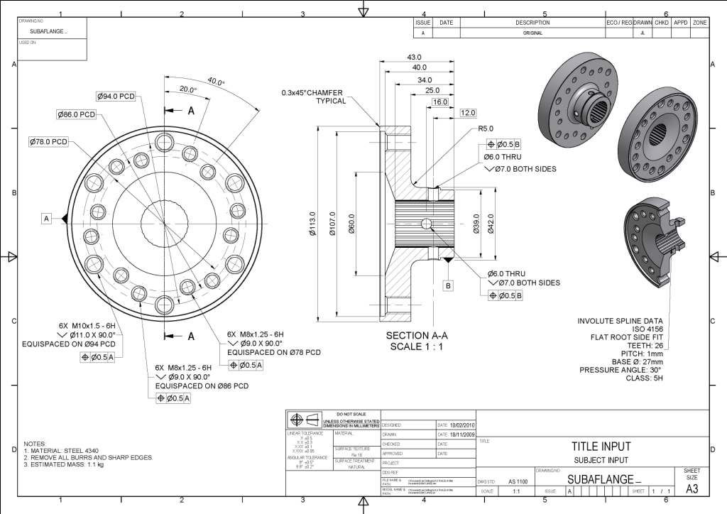

As for cv/axle combos we have that covered. Releasing the new Subaflange shortly. It's a Subaru output flange that allows your current type 1, 4 or 930 cv and axles to bolt straight up. No need to change your setup. Same width from flange face to face as an 091 box with vw flange or type 1 box from flange to flange depending on where you put the roll pin through on the splines.
