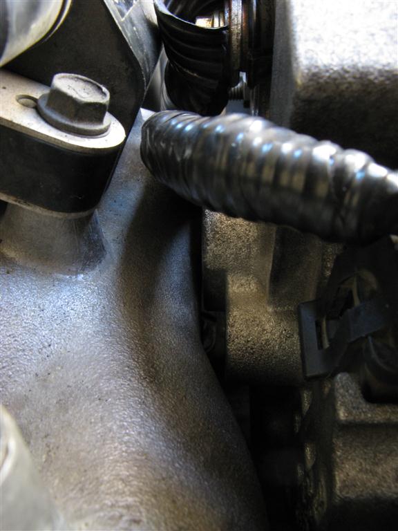

My alternator was from a Camero, and is the "six-twelve mount" style. I got that on eBay. Here are the parts I purchased from alternatorparts.com:
241257 5-groove pulley.
41010782 200 amp heavy duty stator.
DR5180PF Transpo rectifier.
D1C120 Wiring repair harness.
I measured 111A at idle and 190A at speed. Goodyear 4050340 belt.
The brackets are custom made. The aluminum bracket for the PS pump and stock alternator was modified by cutting off the stock alternator mount. The pics show the parts I made - the slotted adjuster bracket and the two adapter brackets on the AC compressor side. The slotted part has a little offset in it at the bottom.
This mod could be reversed with a new PS pump aluminum bracket.
For the wiring I basically hooked the L (lamp) lead through a 470 ohm 1/2W resistor to switched 12V from the stock alternator wiring. This resistor is located in the harness. I also hooked the L lead to the alternator lamp so the dash lamp works. The reason I needed the resistor is because the Vanagon alternator lamp does not draw enough current to get the alternator going.
