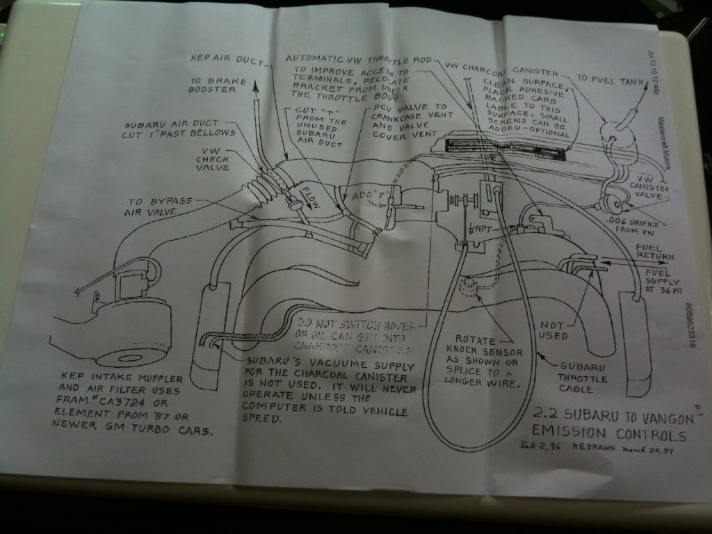

PostPosted: Wed Jul 14, 2010 9:26 am    Post subject: Finally got the Bar Code from the Referee!! Reply with quote
The CARB Referee Saga
I now have a barcode sticker for my 2.2 Subaru powered Syncro westy.
For those interested in obtaining one, there has been a change in policy and CARB will now issue bar codes again.
Last year they were trying a policy of referring all Kennedy conversions directly to smog shops, but smog shops were refusing to do the smog test without a bar code on the vehicle, even though technically, a Kennedy conversion is legal without a bar code.
I went to the referee that works on Thursdays and Saturdays at Santa Barbara City College. His name is Herve and he is a very nice and helpful man. I think this was his first Subaru conversion exposure. I provided him the phone number for Mastercraft motors, who did the installation. They apparently answered all his questions, because he came to me after about an hour, and announced he had good news and bad news.
The good news was my van passed, and was qualified to receive a bar code. The bad news was the state computer system was down, so no bar code would print.
He told me to come back the next day, which I did. State computers still down. After an hour and a half of waiting for the computer to come up, Herve realized nobody was going to fix the system on a Friday. Apparently the state does not work on 3 Fridays per month, due to budget issues.
So, I was forced to make yet another Referee appointment. I chose Evergreen College, where I was turned down the first time, by a man named Terrence.
I find Terrence very intimidating. In any case, I provided him with the Kennedy paperwork, that is, the Executive Order. But for Terrence that was not enough. He wanted the "Installation Manual" also. When I told him I did not have one, he said I would have to reschedule.
I pleaded that he finish the process and not make me come back for a 5th time. His flip response was, "it doesn't matter how many times you come back."
Another phone call to Mastercraft motors, and thanks to Seth's excellent service, Terrence received a one page "instruction manual" and proceeded to do the test. (photo attached, must stand on your head to read it, but can be printed):
Im pretty sure this was Terrences first Subaru also, he got stuck when he found the Cannister Purge Solenoid vacuum lines were not attached. I explained this was normal, to which he said, "I need something in Black and White", which Mastercraft Motors provided.
After about an hour of running my motor at high RPM, and making my radiator fan come on repeatedly, Terrence finished checking everything he could think of, including the gas cap. He then printed me a bar code and stuck it in my engine bay.
I went home finally happy this was over.
For what its worth, I did not volunteer the location of the computer, and he did not look for it. I dont think he checked for stored CEL codes, but I could be mistaken. My Cel light works, and was not showing any active codes.
By the way, Herve DID ask to see the computer, and asked to see the codes, so I showed him how to connect the green connectors, and that I had no codes. I did not show him how to connect the black connectors to read stored codes.
I had recently been getting code 22, intermittently, turns out it was a bad knock sensor. The van passed in that condition. I had cleared the stored code before going to the Referee.
