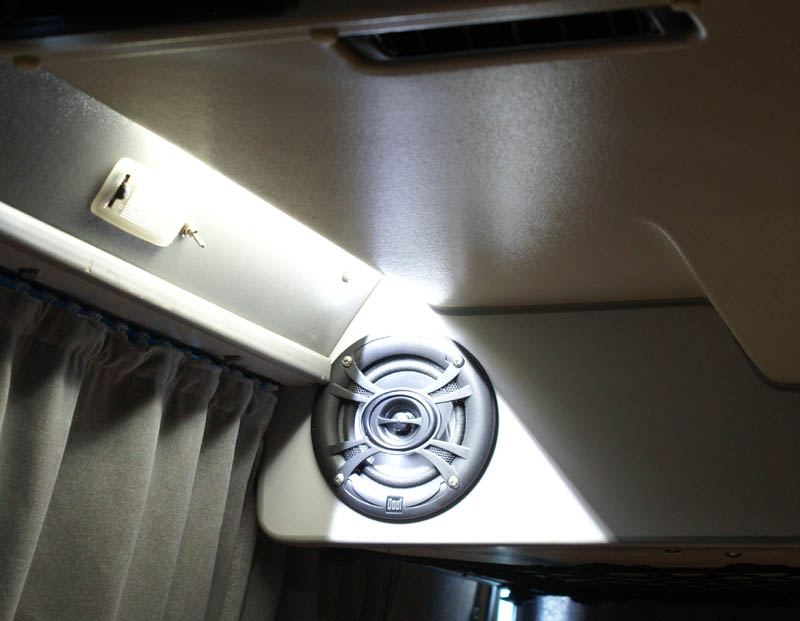

ClimberJohn you got me thinking Mood/Work light so here's my compromise.
Mood Only
Mood with work
Only Work
Work plus Stock
The Whole ShaaaaaaaaaaaBang!
I'll clean up the wiring after work tomorrow and add another switch to the Kitchen panel
for the new Work light.

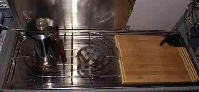

I like the cutting board you have over your sink. Any info on this little gem?
Mark
87 Westy, 250k GW 2.4 - 2.0 Wink, 16" wheels
Timwhy
Joined: January 01, 2009
Posts: 4101
Location: Maine
Timwhy is offline
PostPosted: Tue Jan 11, 2011 4:06 pm    Post subject: Reply with quote
markz2004 wrote:
Timwhy wrote:
Tim,
Mark
Not my idea Mark, but I too like it for cutting up Oranges for the Blue Moon!
I can't remember which Samba member posted the pics of their cutting board but
I too liked it.
My cutting board is Bamboo and is the perfect width of the sink, I did have to cut
the length down and cut a notch in it to keep it somewhat in place. Also there is
a notch taken out for the faucet. I think the origainal poster of the idea put
bumpers on the bottom of the cutting board to line up with the sink well for more stability.
It may have been from the What Have You Done Thread, sorry can't remember.
I'm sure some bright individual will speak up and take credit. Any way if you need
close up pics let me know?

Found one more spot to put the extra string of LEDs.Tied it into my dome lights' power,
but not controlled by the door switch. I added a switch for off/on and I think it's
the right amount of indirect light on that side of the bed/back. The pic makes it look
much brighter than it actually is.

I continue to work on my Westie’s lighting, albeit slowly. Back during the holidays I installed one of Oznium’s bright little 2W warm white LED floodlights over the engine bay.
This little puppy does a fine job of lighting the engine but is definitely too bright for someone using the lower bunk. So, I milled some scrap ¼” tk. diffuse acrylic to make a little diffuser for the fixture.
The diffuser is made from three circles, all 2” in diameter held together with three 6-32 stainless steel machine screws. The upper circle has an inner cutout to press fit on the outside diameter of the Oznium light’s aluminum housing / heat sink. The middle circle is just a thin ring while the lowest circle is solid. I did mill the center of the bottom diffuser to 0.10” tk. to allow more light transmission. I have been very happy with the way this works. It slips on and off easily and makes the light quite comfortable to the eye.
Cheers,
