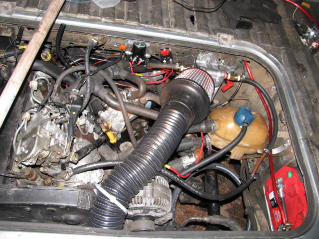

PostPosted: Mon Jan 17, 2011 7:54 pm    Post subject: A Fuel pump is a BAD idea!! Reply with quote
after much debate here, I at least talked him into a Fuel pressure regulator. Well couldnt get the van to start anymore without the batt dying so we went and got an optima today and installed it in the rear, theres a batt disconnect inline so it was an easy add and soon I will put a solenoid as the main is the new aux. well, between the optima, the tdi starter and all new grounds, its cranking like its on speed!! Well its running pretty good, kinda sloppy but enough to pull it out of the garage, add some more diesel and some treatment, and let it run some problems out. FPR is set on 2.5 which I believe is 25 psi. its running good, all of a sudden, IT WENT CRAZY!! running out of control, after a lil rev, took off full rpms, I dove through the side door and turned it off as fast as I could. after a few more tries, still was going nutz! My heart was heavy Crying or Very sad Rolling Eyes
I thought we blew the injection pump. well we pulled the pump and the inline FPR and back to business!! moral of the story NO FUEL PUMP, and listen to Brent from now on Laughing I was happy, its moving under its own power and will be on the road, as soon as I get these brakes ironed out.
few other problems, temp guage is not responding but when I turn the key on, climbs to the top, fuel guage does too but then settles at 3/4 which i think is how much fuel we have in. checked it with a test light and theres not power there, I have the yel/red from t7-2 hooked to the sensor on the back of the head. the water output has a water temp plug on it but I have no way of hooking to it and no junkyards to go to Crying or Very sad
ran it for awhile no radiator fan, but hot hoses so I called it quits. Def should be on the road real soon!
heres your pic, theres def stuff that I dont approve of, but we've just tried to get it together and will iron things like a better looking air filter! but you can see the spot for the optima Cool and my sweet solenoid setup for the glow plugs! to the wolves

PostPosted: Mon Jan 17, 2011 11:43 pm    Post subject: Reply with quote
why is the air filter there and not up the left rear shaft? That rig looks better than mine (I mean the air filter hose & filter). What is it? I have a K & N?

well the runaway was gone, now its back. on the top of the valve cover that piece is leaking oil back into the turbo intake feeding oil into the motor causing it to runaway. I'm unsure of oil level. I think it may have to much oil. we've drained the oil previously and replaced with only 4 quarts, well were trying it again. I removed the tube on top of the valve cover now it doesnt it start. but Oil dripping out as it cranks over.
88 westy suby 2.5

PostPosted: Tue Jan 18, 2011 2:20 pm    Post subject: Reply with quote
Do you know the history of the engine? If it was overfilled, oil could have gotten up into the breather. It is also possible the engine has too much blowby and compression is forcing the oil into the breather system. Mine will spurt a slight mist with the engine running, but not enough to run on to the ground and leave a puddle. Perhaps running the engine will seat the rings back in and the blowby will be reduced. You can run the valve cover hose into a catch can for now. The catch can needs to vent. Cap off the other end for now. I can't tell you why it won't start now. A runaway diesel is a scary event. You will need to go back and check the basics. Verify the glow plug amp draw, crack the injector lines to be sure the pump is still primed. Not knowing how bad it ran away, it is possible the valves may have hit the pistons. A compression test will determine if that happened. How does it sound when you crank it. Also it sounds like you have some electrical shortcuts. Be sure the pump cutoff solenoid is getting power with the key on and during cranking.
edit: a clear supply hose between the pump and filter is helpful for diagnosing engine running problems.

PostPosted: Tue Jan 18, 2011 2:31 pm    Post subject: Reply with quote
Ohh what a run away train wreck, it could end up being.
I speak from my own experiances. of course.
GET YOUR DIPSTICK IN PLACE AND WORKING.. I understand the challanges, I've a few issues when I oput the TD into my 1980 camper a few ye4ars back, and in mom's 2.5l eurovan swap I had to drill the block and install a tube.
the Engine crankcase NEEDS to vent, it DOES NOT need to vent into it's intake. seperate the 2 from each other till you have crankcase pressure sorted out.
catch the breather vapors into a 'catch can' for the time being and if you have excessive oil then fix that issue. it should breath, but collect very little measurable oil.
2ndly and this again from experiances in self destruction.
you NEED TO HOOK the AT trans kick down into the throttle cable.
it is a 'varied' input that effects the firmness of the shifting based against the AT governor, if you leave it disconnected you risk damage to your friction discs (too soft a shift) or it won't up shift till 45+mph and that's just plain unfun in traffic.
on my brother's AT conversion (Audi 5cyl turbo fwiw) he ran a 2nd cable to the front (bulk bicycle sheathing) pedal 'bellcrank' attachement.
this AT cable enacts the kickdown as well, so the Engine throttle has to stop(bottom) before the AT cable, which will have a click into 'kickdown'
on Mom's AT conversion (eurovan 2.5L fwiw) I made a cable using a MK-I/II golf/jetta/cabriolet AT throttle cable which includes a sprung slipjoint section to allow movement after the T-body is WOT. on
on this install I used the stock vanagon AT throttle cable from pedal to AT lever, then made as necessary the modified (t-body was too distant) MK-I/II cable relay.
