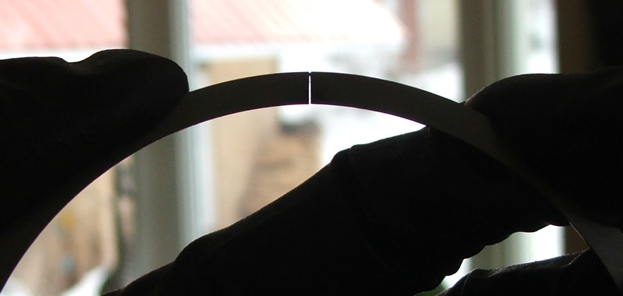

Pascal
Joined: January 13, 2006
Posts: 833
Location: Fredericton, NB, Canada
Pascal is offline
PostPosted: Sun Feb 20, 2011 12:01 pm    Post subject: Reply with quote
Here is my picture. Hard to get a good quality one.

Howesight
Joined: July 02, 2008
Posts: 3395
Location: Vancouver, B.C.
Howesight is offline
PostPosted: Sun Feb 20, 2011 12:08 pm    Post subject: Reply with quote
Hey Pascal:
That little nib on the outside diameter of the ring has gotta go. Your feeler guage is not measuring it, I suspect. Use a good quality ring file.
Pascal
Posts: 833
Pascal is offline
PostPosted: Mon Feb 21, 2011 9:17 am    Post subject: Reply with quote
I asked the company I bought my piston and liners from if they were in fact Hastings rings and they said they were either Hastings or Grant rings. They go back and forth between the two dependign on availability. Can anyone tell what brand these are? Thanks
'84 Westy - 2.2wbx, GT Torque-Biasing Differential
'91 EA Cabby

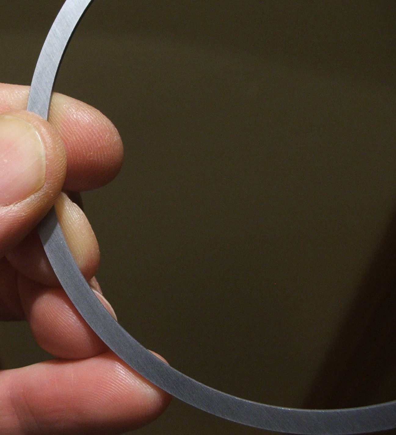

Pascal
Posts: 833
Pascal is offline
PostPosted: Mon Feb 21, 2011 7:15 pm    Post subject: Reply with quote
Here is a closer view of the top ring showing the machining marks.
Tencent, are the chrome rings shiny when new? I have a slightly used set of rings and the top ring was very shiny. This one is not shiny at all. I know it's not aluminum but it look just like brushed aluminum. Thanks
'91 EA Cabby
tencentlife
Joined: May 02, 2006
Posts: 10147
Location: Abiquiu, NM, USA
tencentlife is offline
PostPosted: Mon Feb 21, 2011 7:31 pm    Post subject: Reply with quote
That's how they look.
Experience is death to doctrine.
morymob
Joined: November 09, 2007
Posts: 4683
Location: east-tn
morymob is offline
PostPosted: Tue Feb 22, 2011 6:52 am    Post subject: Reply with quote
Gotta do search later but somewhere recently i heard Grant now owned by Cofab, if so might explain some quality issues.
