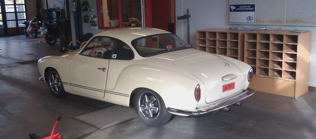

It has been a while since my last update, but today I finally felt ready to take the car to the road authorities to have all the changes approved.
In Norway, the rules are really strict when it comes to changing a car from its original specs, so I have to have an approval for the wheels, the lowering and of course the engine.
After some weeks and months with e-mails back and forth, I finally got the green light, after some important documents from the brake system manufacturer and Norwegian importer were submitted.
So today I took the car to the local test station, and everything was approved Smile
I still have to go through a regular bi-annual inspection to check lights and brakes etc, but that's just a formality at this stage.
So give it a week or two, and I am actually allowed to take this ting to the road legally Smile
Here's a shot from when the inspection officer took it into the inspection hall:
