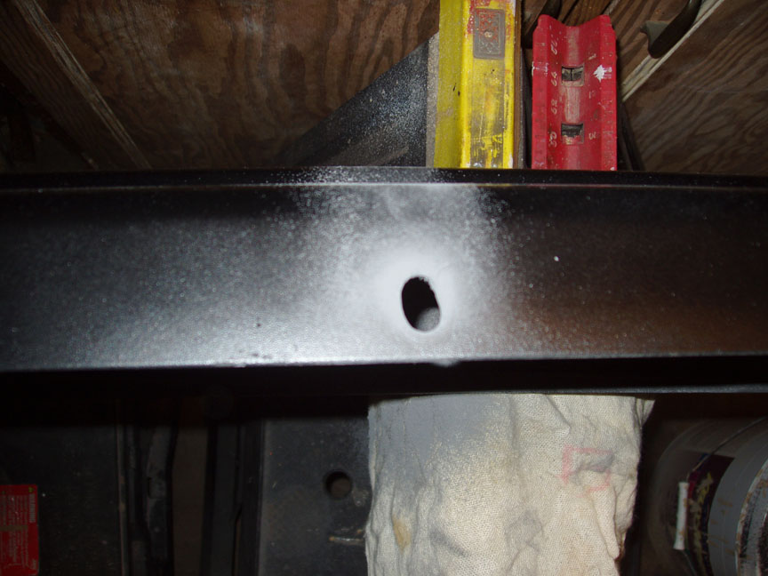

UPDATE:
New fitment.
Set up to align.
Not happy with how the bumper sat, I ovaled out the lower bolt holes in the f/g bumper.
The original hole is to the lower edge of oval in photo.. about 5/16" round.. ovaled at an angle to shift the bumper slightly to center over the new hitch and sit evenly around the van's corners.
This bought me another 1/4"+/- clearance from pin hole edge to bumper face. It now measures 3/4" from pin hole center to bumper face.
Will be getting an anti-rattle pin in the mail soon.. It should fit with a little room to spare now.
All cleaned up!
This hitch took a little work to get just right. In the end? I am very pleased.
Money well spent!
