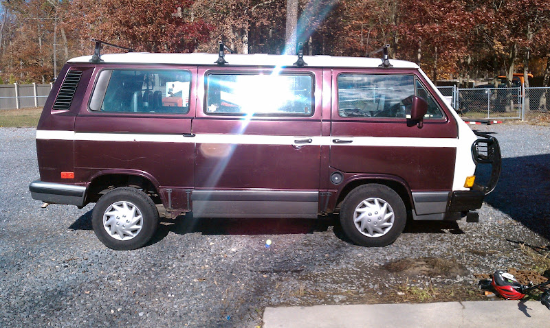

Van started to push coolant and was getting bubbles in the overflow tank. Decided it was time for a swap. Started looking at craigslist and found a 97 wagon with 82,000 old lady miles that runs and drives but t-boned sitting still. $800 bux later and its mine. Going to go all smallcar. Right now making plans to strip it all out and do the head gaskets and try to source some torker cams. Anyone know any good sources for after-market suby cams? _________________ -cliff

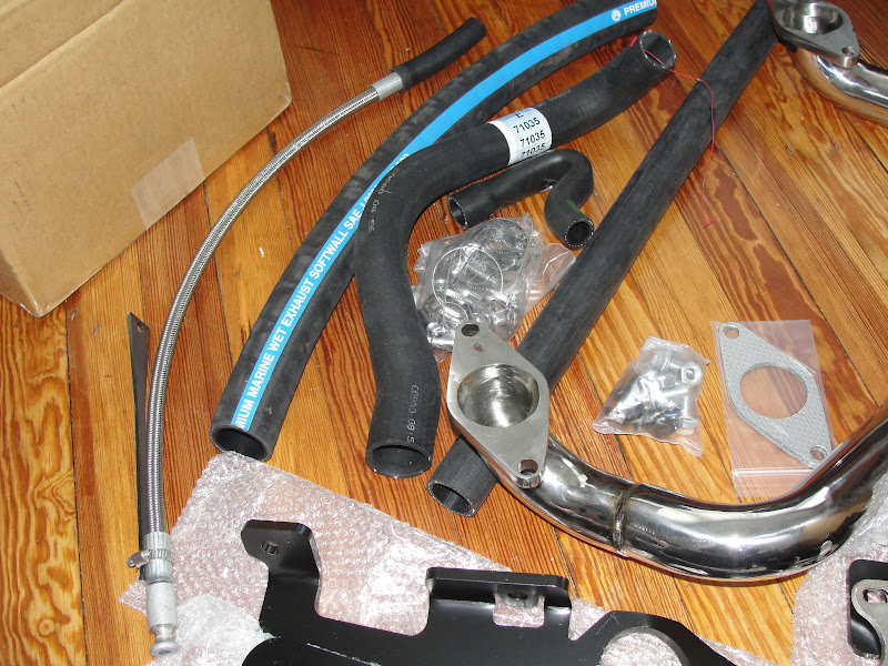

Got the first of 4 shipments from small car in the mail today. So far very pleased with the quality of parts that I have reciveded. I decied to purchase all of their conversion parts inlcuding the whole stainless exhaust. Total cost from smallcar:
AT conversion kit with quiet power steering hose, oil pan, flex dipstick, coolant manifold, and harness service, full van stainless exhaust:

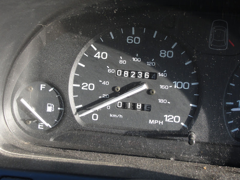

was thinking about the delta cams and still may. It's a 2.2 elderly lady car that was serviced and repaired only at subaru so I'm probably going to do the t-belt water pump etc and toss her in the van. _________________ -cliff

Someone beat me to the wheels. I guess I'll run stock steels with 27x85r14. May go with Maxxis Bighorns, or Gereral Grabbers. The grabbers are priced right so will probably buy 5. Got more swap goodies in the mail this am:
Full stainless exhaust with cat and 2 O2 senosor ports:
EJ22 oil breather plate and seal kit from ebay vender even comes with new hardware:
High output Porsche starter SR68X thanks to thesamba.com recommendation:
Flex plate adapter and hardware:
So far my dealings with smallcar have been positive. Looks like I have everything, it would help if they included a packing list that itemized everything that should be in the box. That is their only flaw so far and where bostig definitely has them beat. I just didn't have a bostig budget plus I like where the suby power is. Next I have to get wrenching! _________________ -cliff
