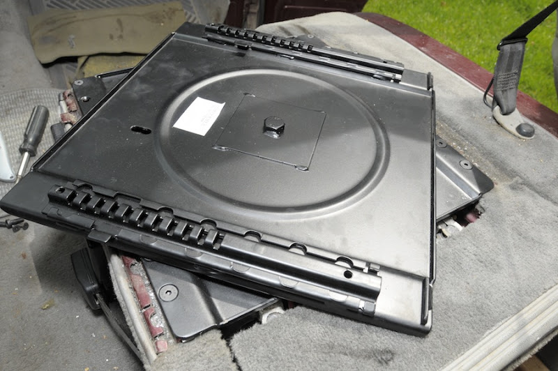

Here is a shot of the swivel fresh out of the box. As you can see it came with some mounting hardware, but nothing too special. The first step, of course, is to remove the old seat. No big deal there, it just slides forward until it hits the stop. The stop is on the left side of the passenger seat and all you have to do is lift it up while sliding the seat forward. (Took me a second to figure this out! Embarassed ) The seat then slides completely off the rails. After placing the swivel on top of the existing rails I realized a couple things:
  1. I would need to drill a couple holes.
  2. I would need to cut back the battery compartment cover.

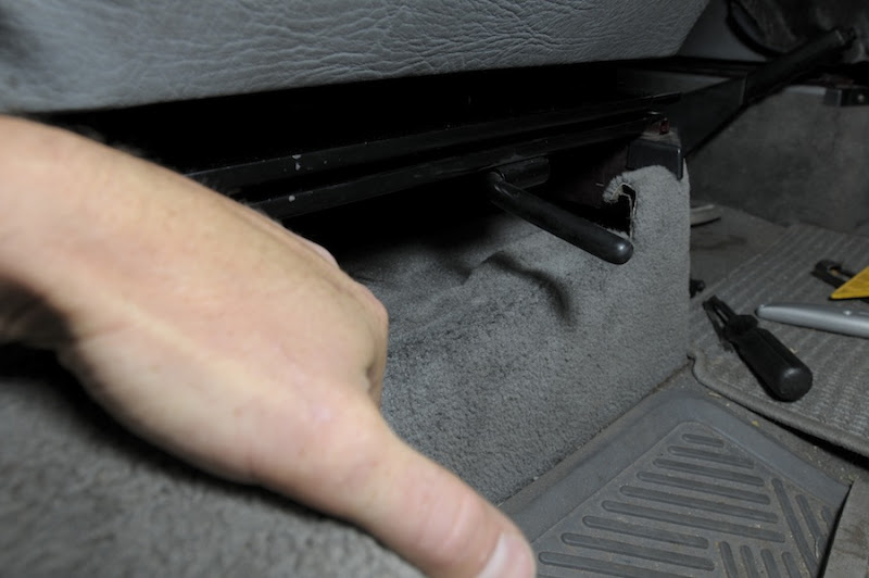

The last thing I wanted to do before installing the swivel was cut a little access hole in the front of the seat base to create a cubby hole under the seat. This was easy to lay out and then cut with the jigsaw. Here is the finished product with the carpeting laid back over the new access slot.
Now I was ready to install the swivel. Two of the small bolts fit through the holes in the front of the rails with the square nuts to hold them in place and the four larger bolts fit through the holes on the back. The large bolts had a cool little piece with nuts welded to a plate to ease installation. Check it out.

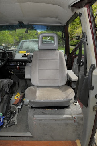

This is the swivel bolted into place on top of the old rails. It was a simple installation and did not take long at all. You can see the small gap between the battery cover plate and the swivel, perhaps this could be done better but I felt it was suitable enough for me. With the battery compartment door open there is still just enough room to fit in jumper cables, but a cool idea might be flipping the battery around so the terminals are closer to the hinged side. This would require reworking the cables though and was more of a project than I was looking to do for the moment.
After all was done I simply slid the seat onto the rails of the swivel and was finished.
Swivel seat installed!! Here is a little shot of the cubby hole access, it still needs a little work to be completed.
Well, that's all I've got for you, hope it helps and that it shows a different option for those of you looking to install a swivel in your Vanagon.
