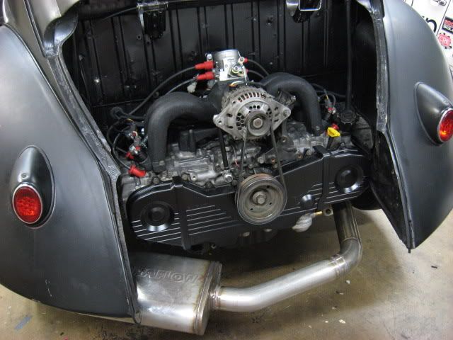

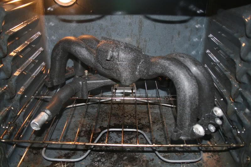

Got it running today! Don't worry about the little fireballs blowing out of the open header. I know they're pathetic, so I'll be sure and tune it for larger fireballs. Laughing
http://www.youtube.com/watch?v=LlVHKImHc6o
There is still no coolant in it, some stuff still needs to be buttoned up, and we've done no tuning at all, but now I know that the $180 Pick-N-Pull engine doesn't have a knock, which is a huge relief.

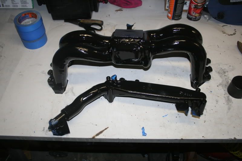

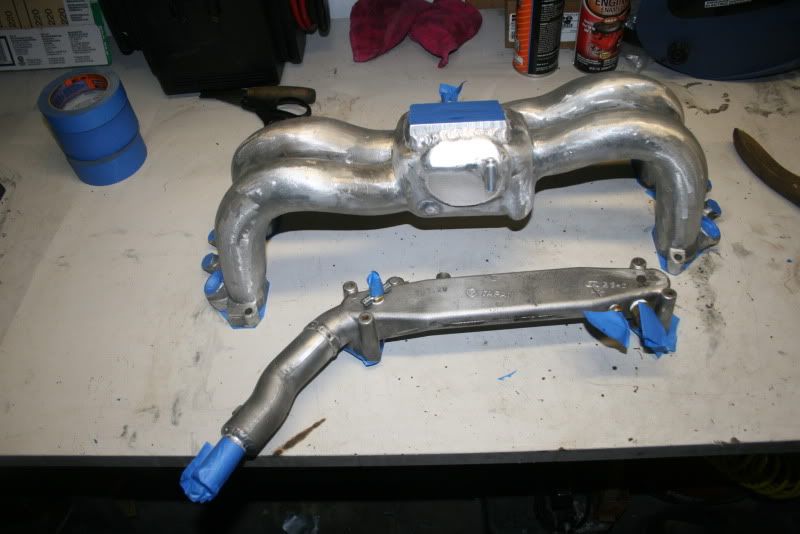

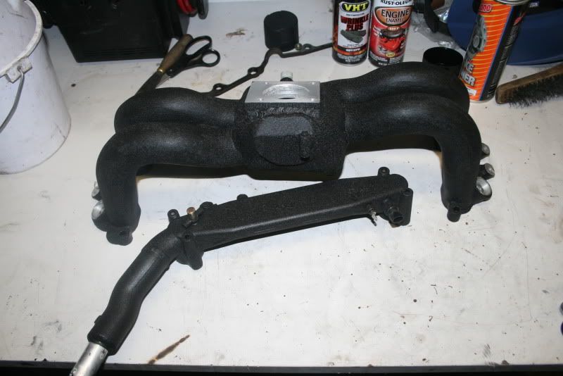

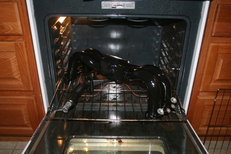

After we took that video, I pulled the intake manifold and crossover pipe off the engine, and painted them in wrinkle black paint. Here's the process:
Cleaned up and masked off
Two coats of VHT wrinkle black.
1 hour at 200 degrees.

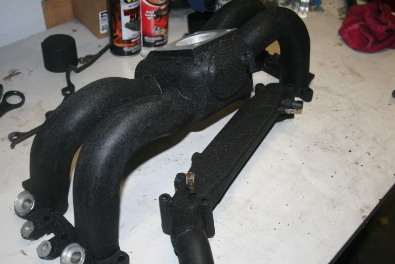

Sneak peek after 30 minutes! Don't leave the oven open too long or it won't rise!

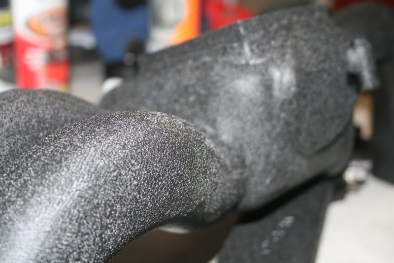

Wrinkly, just like a stock WRX manifold!

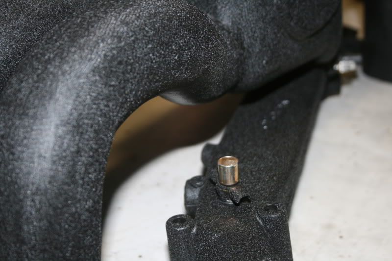

I painted over the parts of the sensors and petcock which aren't critical for contact, and not on threads. I just wanted to help hide them. They're all installed on the back side of the manifold and crossover pipe to help hide the wiring too.
I also painted the alternator belt tensioner that Jeff made for me today.

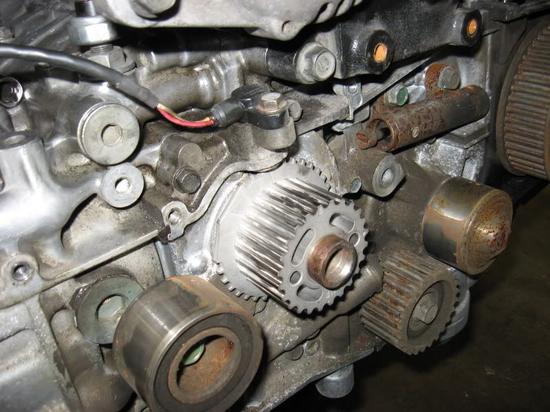

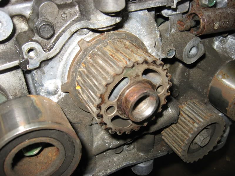

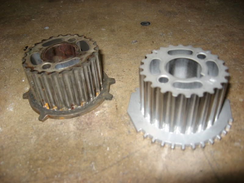

We are running a batch fire setup, not sequential. So yeah, it doesn't use a cam sensor, just the crank position sensor. IF you wanted to though, you could run sequential injection with Megasquirt.
I am not sure the exact years, but here's the part number for the STI trigger wheel that I got:
13021AA141
And here are some pictures comparing the stock EJ22 wheel to the STI wheel:
The way it was explained to me is that you can program the Megasquirt to use the stock EJ22 wheel as a 4 -1 setup, but cutting two of the teeth off of it. But the resolution is pretty low, so you can get hard starting conditions or a rough idle. The STI wheel is a 36 -2 -2 -2 wheel, so it has a much finer resolution.
And with it being $22 from the Subaru dealer, it's a pretty small investment for a smoother running engine.

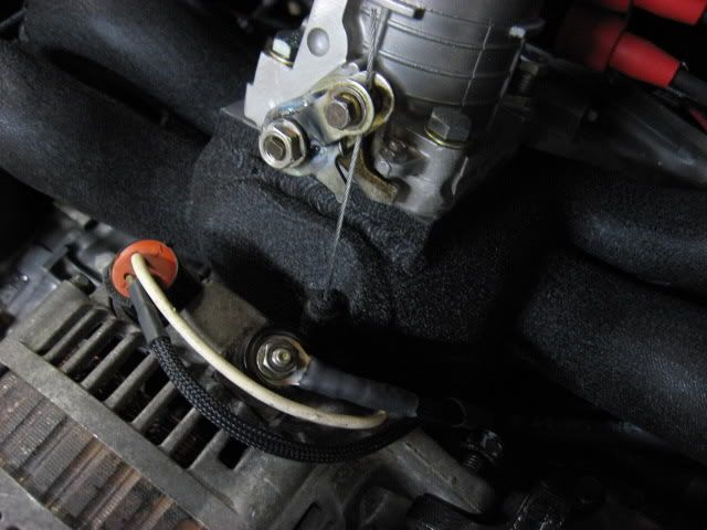

And here's a test fit of the painted manifold:
Little hidden throttle cable stop:
A bicycle cable housing goes up into that stop, and runs down to the throttle cable tube that comes out of the pan.
I didn't like how the alternator or pulleys looked, so I have painted those and am waiting for them to dry enough for a second coat before I go to bed.
I just ordered a pair of axle assemblies from Autozone earlier today. Very pricey, but they have a lifetime warranty on them. Laughing
Considering that I am leaving stock axles on the bug to help preserve the transmission, I have a feeling I'll be using that warranty... a few times.

OTO X58 wrote:
norcalmike wrote:
OTO X58 wrote:
vwluver74 wrote:
HELL YEAH!! Very Happy
Thanks!
My wife's pissed that the house is full of paint fumes, BTW. Laughing
Women Rolling Eyes Laughing
She's also pissed that I posted pictures of the dirty oven online. Laughing
Funny. I didnt even notice the oven. I doubt anyone else did either
70 140
