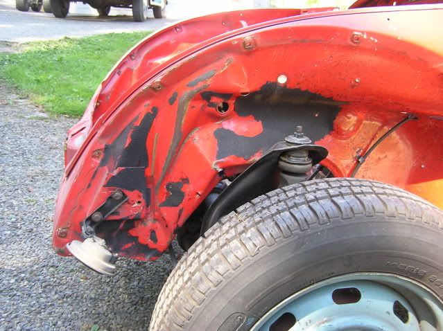

Repairing rust on the inner fender.

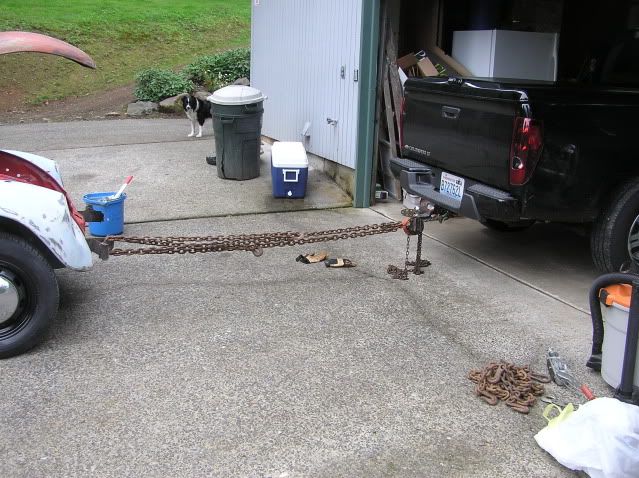

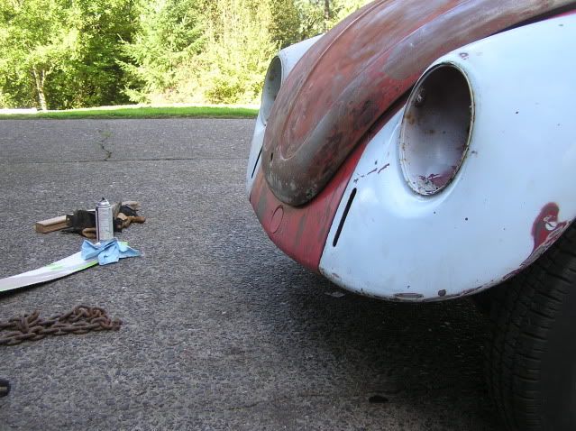

It appears that this car had a front end accident at some point in its journey. It looks like the inner fender may be pushed back. What do you think?

PostPosted: Wed Apr 27, 2011 1:12 pm    Post subject: Reply with quote
Mine was tapped in the front similar to your's. I was able to pull with a come along and a little heat.
