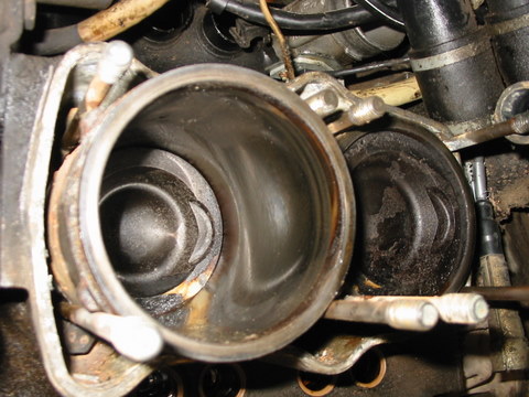

Looking at your sleeve (picture above) this engine didn't had a good water/coolant mix, the rust shown on the (bad ha ha) picture tell me that this is why your have so much trouble.

so, i gave it another go, and finally pulled that friggin' head off. this triumph of strength and perseverance was a rather joyous event. however, it would appear one of the sleeves came out too far (the other slid back with minimal finagling).
how do i know for sure if it's out too far? i crank the pulley, but the piston moves along with the sleeve, no matter how i finagle.

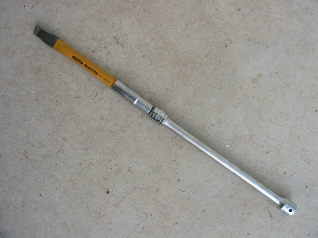

and here's what i managed to pry the stuck sleeves with:
thanks to everyone who's helped me out so far. without your reassurances that i could get the sleeves unstuck, i almost certainly would have given up. the annoying thing is, it was just a baby tug that freed them. if you have very stuck cylinders, i recommend (as many recommended to me) buying/inventing the longest, fattest, torquiest lever you can fit in there. no screwdriver i've ever seen would be capable of freeing cylinders as stuck as mine were.
i don't think that chisel's coming out of the 13mm socket anytime soon.

If you did pull that cylinder past the rings, the engine does not need to come out. You can make the chamfer at the base of the cylinder bigger using a grinder to make it easier to slide back on. Use a split type ring compressor.
