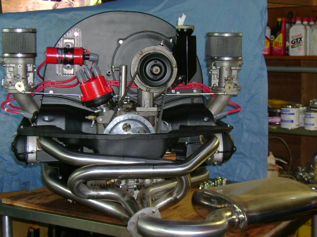

wildman1
Joined: December 30, 2003
Posts: 674
wildman1 is offline
PostPosted: Tue Dec 13, 2011 11:50 pm    Post subject: Reply with quote
Here is the IDF/DRLA CSP linkage kit on shorter 4.75" non-offset manifolds. This set up would clear factory heat outlets on a German shroud. Picture is before the CB Performance CNC Big Beef manifolds. 7" tall, non-offset.

wildman1
Posts: 674
wildman1 is offline
PostPosted: Wed Dec 14, 2011 8:35 am    Post subject: Reply with quote
Mark, it cleared this set up when I had the factory shroud in place, it was about 1/16" gap at closed throttle. I guess I got lucky? I have read of others clearencing as you did, and read of some that didn't have to.
Same with the center pull clearing the lower left backingplate bolt head/tin. One center pull cleared with no issues, the second kit I bought was different all around, in little ways, but non the less, clearencing was needed there.
Steve, modulation is superior with the CSP linkage and it seems to have a decent ratio even with severe angles. Full throttle was equal to within an acceptable amount. The hardest part is adjusting the rod ends behind the distributor, "if" you have one.
I like the cable/pulley ideas floating around, but they too have cons. Good Luck.

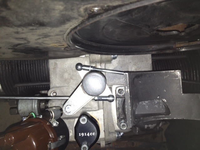

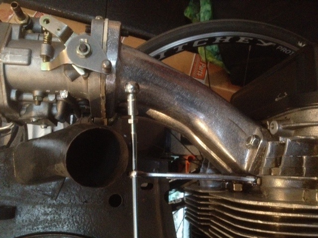

PostPosted: Sun Mar 25, 2012 9:18 am    Post subject: CSP linkage mod, out of sync mid range. Reply with quote
I was looking for more info here earlier too.
As there are multiple variables in the "clearance" issue I thought I'd post more pictures as some may be running similar problems as I try and resolve mine. Pita, after forkin out for a csp and these manifolds.
The solution I've come up with has revealed to me I obviously know little about the science and math of linkages. Maybe someone would care to explain or school us all in what we'd need to understand to resolve the prob I'm having?
2276 CB Big Beef Manifolds (offset manifolds) 44idf + csp idf kit + doghouse shroud.
1. Rods provided don't reach right carb.
2. Heater duct in the path of rod. (wrench holds rod at closest point to avoid shroud contact)...my attempt at figuring a diff solution.
Above shows the problem and below is what I thought the solution would be:
Problem is this:
The throttle opens in sync now, yay! It also stops in sync! Yay. But crap! It's not in sync in between. The left carb butterfly opens at a rate much quicker than the right. ? Wtheck!? ........WHY?
With the mod and offset manifolds here's a top down of the csp bellcrank w closed and open throttle.
Any input appreciated.

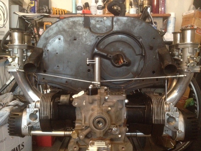

Steve Arndt
Joined: August 01, 2005
Posts: 1797
Location: Boise, Idaho
Steve Arndt is offline
PostPosted: Sat Mar 31, 2012 12:33 pm    Post subject: Reply with quote
I added 1 inch to the link rods (braised). That made it work with Redline throttle bodies and CB tall IDF manifolds.
Kind of a bad pic here, but you get the idea.
Steve
gprudenciop
Joined: July 06, 2008
Posts: 606
Location: portland or
gprudenciop is offline
PostPosted: Sat Mar 31, 2012 12:49 pm    Post subject: Reply with quote
Looks like you changed the geometry of the linkage since the manifolds and other parts are the same you could try adding that same mod to the 3/4 side?
youngstah
Joined: December 28, 2008
Posts: 89
Location: california
youngstah is offline
PostPosted: Sat Mar 31, 2012 6:24 pm    Post subject: Reply with quote
I guess that's where Im confused, the change in geometry.
Is it the angle in the top down shots that matters or is it the angle and length of the rods from the bellcrank to manifolds? (facing the engine from the rear)
The rod still moves the same amount as before, right?...or do I have that entirely wrong? What puzzles me is that at idle it matches and at full throttle it matches, just not in-between. What angle or logic affects that?
modok
Joined: October 30, 2009
Posts: 27687
Location: Colorado Springs
modok is offline
PostPosted: Sat Mar 31, 2012 8:02 pm    Post subject: Reply with quote
Look at what angle the rod is compared to the pivots at half open. Should all be 90 degree angle, or all the same at least, if not you have a progressive linkage, it may be good idea or bad, I donno.
You bent rod you'll have to imagine it straight, or as a kangaroo
youngstah
Posts: 89
PostPosted: Sat Mar 31, 2012 9:08 pm    Post subject: Reply with quote
Thanks Modok.
What I think you're saying is, with the butterfly at 50% the goal is to have the rod perpendicular to the throttle arm. Point one being the pivot (ballend) at the bellcrank and point 2 being the ballend on the carb linkage...draw a straight line between these two and thats the line to use?
What exactly contributes to a "progressive linkage"?
modok
Posts: 27687
modok is offline
PostPosted: Sun Apr 01, 2012 1:22 am    Post subject: Reply with quote
yes, that is right
So at both ends we have a pivot point(carb shaft, bellcrank shaft), and the "line" between the ball ends of the links.
If it is at 90 degrees, the actual leverage is the distance from the line to the pivot.
Here's the cool part, when it is NOT at 90 degrees, the instantaneous leverage at whatever position is pretty much the distance from the line to the pivot.
I hope that makes sense, maybe a diagram is required?
Having different length levers at different angles, the action will not be linear.
Linear would be 1 degree at the bellcrank moves the carb 2 degree, that is a rate. You will see the rate changes though the travel, sometimes this can be taken advantage of so you have a slower rate near idle for more precise throttle control at part throttle, and a faster rate near full throttle.
Sometimes called a progressive linkage
By moving the carbs up, it appears this will make it somewhat the opposite way, and to fix that you would need to change the position of the little arms on the carbs.
