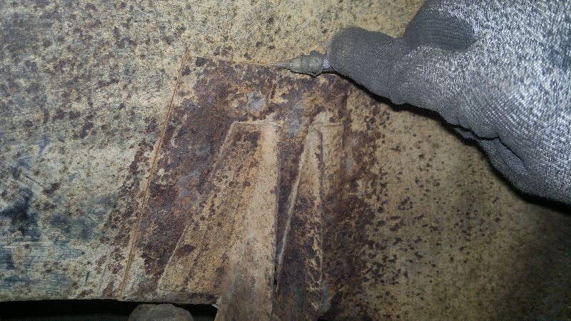

Here's one example story how to renew split rear body brackets
Typical condition of the rear brackets
Mark backing plate placement

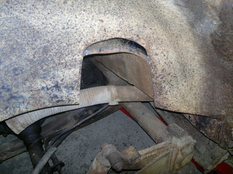

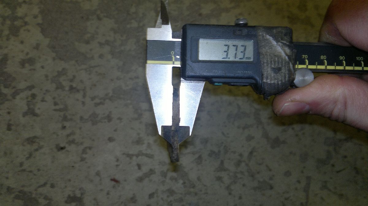

Measure the height to chassis
Open the spot welds, there is also an extra weld on the rear edge
Saw bracket off
Open spot welds to rear luggage tray

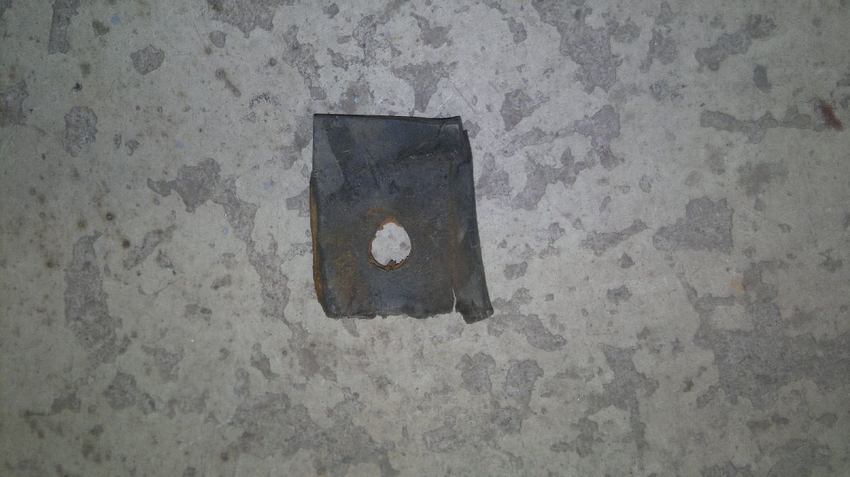

Remove old bracket
Open spot welds on backing plate
Backing plate remains removed
Place new backing plate according the marking made earlier

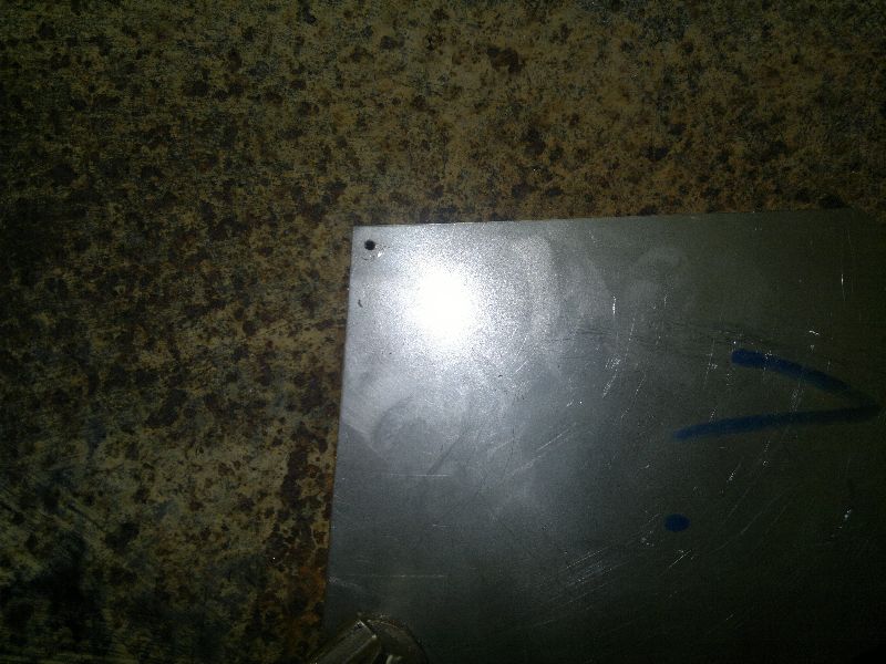

Drill positioning hole on corner when good metal there left. Here 2 mm drill.
Positioning hole.

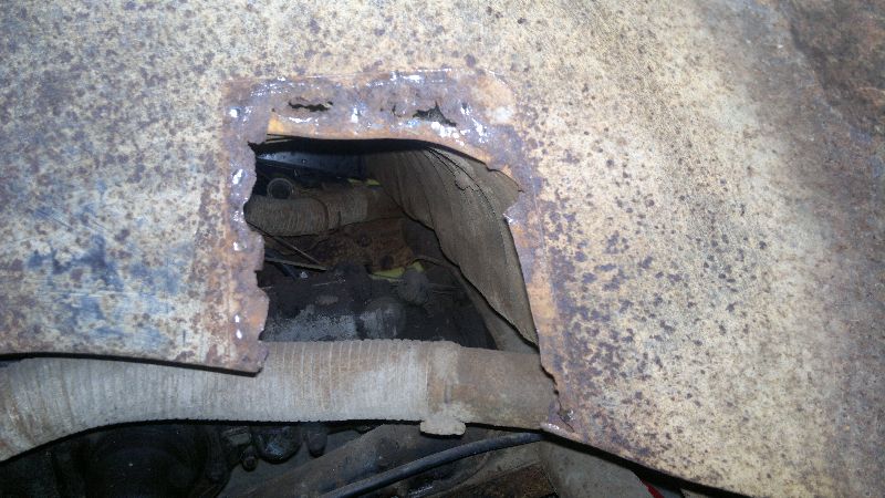

Saw to good material
Rust

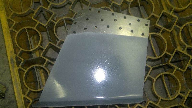

New repair panel with holes to luggage tray

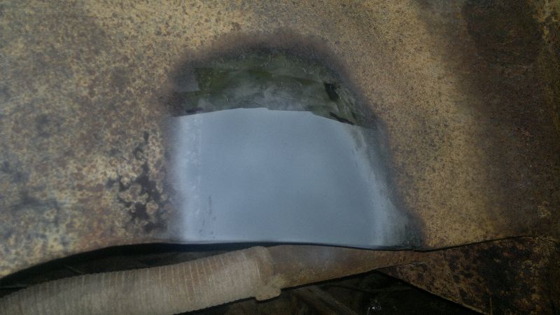

Fitting the panel, some welds applied on sides. Before welding lift the body rear up, sorry no picture here.

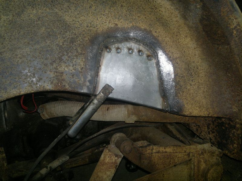

Fit in the panel
Weld

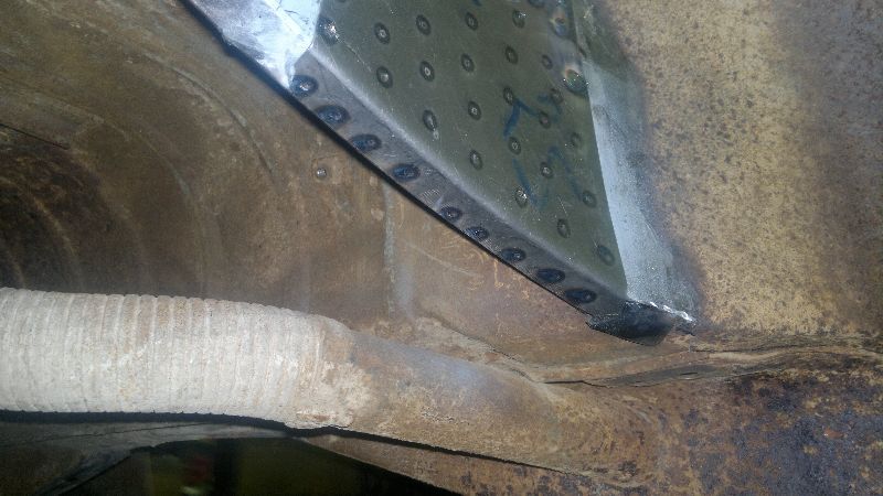

Plug welds to luggage tray
Backing plate with plug weld holes
Spot weld paint on area where spots are coming
Place backing plate according the positiong hole made earlier. Here seen spot welds and plug welds
Spot welds on lower edge

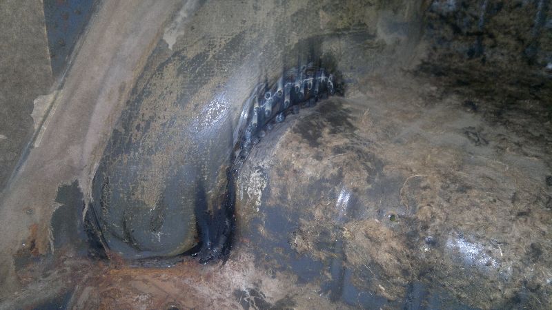

Grinding

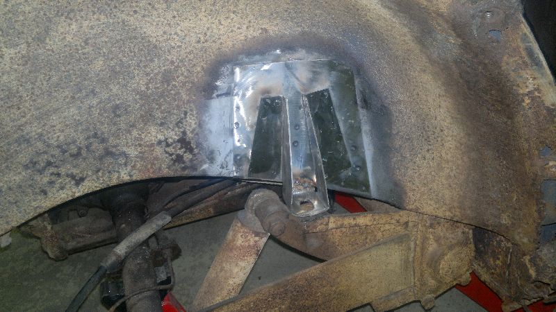

New bracket drilled for plug welds. This can also spot weld but this is critical welding and plug weld by MIG is more secure
Welded
Grind
On luggage area

Wow, very nice write up and pics! My only question/comment might be that prior to welding on the bracket, would it be a good idea to:
1) Bolt it down to the chassis with the rubber pad in place
2) Check the clearance (3.7mm?), this would be the compressed pad thickness
3) Clamp the bracket firmly to the backing plate
4) Plug weld.
??? This would (further) insure that the position/angle of the bracket is correct. This may not be an option if someone is doing a full body-off resto.
Thanks again, posts like this make this forum far more valuable.

He measured the spacing before and it was 3.7mm so I would assume he made sure the new one was at that measurement.
The problem with bolting it on at it's final position is that there has to be a certain amount of crush of the rubber mount so the final position is less than 3.7mm. This will put the body under a slight amount of tension at that point. If you bolt it to it's final position before welding, the body will not have this tension so the mount will actually not be in the correct position.

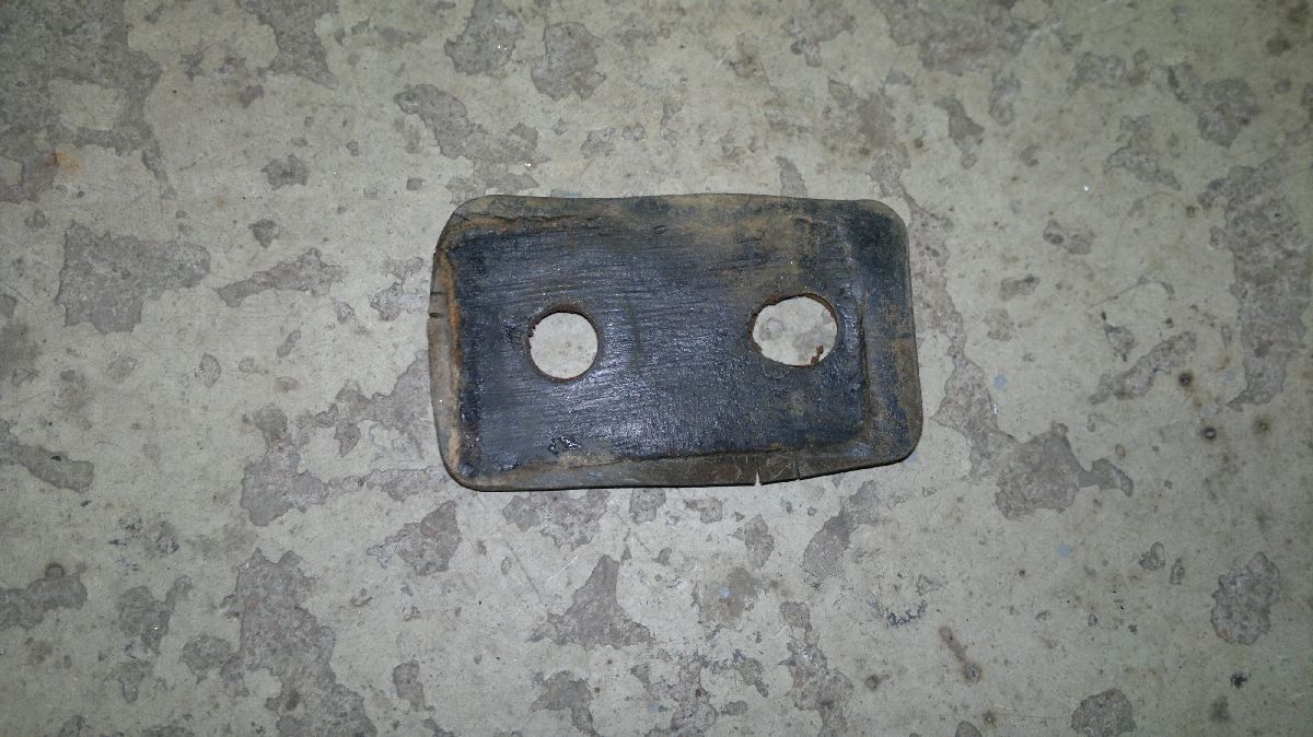

Thanks for your comments, here you can see the original rubbers of this October 1951 made split. The bracket rubber thickness seems to be 8 mm (the inner end was not between chassis and body), and crushed down to 4 mm.
The other pad rubber under back seat is maybe also 8 mm?
